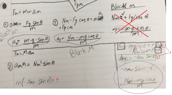

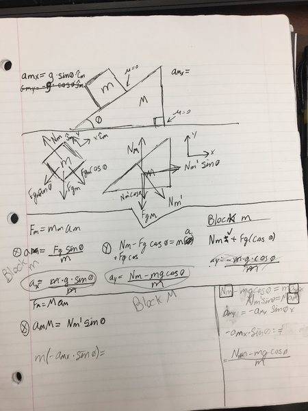

There is no friction between any surfaces mass is known. Find acceleration of the blocks.
F=ma
I'm almost certian
Amx=g sin θ
AMy=0
Hmm... Why wouldn't the acceleration in the x direction be affected by the mass of the objects?
Likes haruspex
VinnieD said:
Amx=g sin θ
AMy=0
Yes, these look correct.
Most of your work looks OK to me.
The part x-ed out in red is incorrect, but it doesn't look like you used that part.
Look at your final equation circled in blue. Can you see a substitution that you can make for ##N_m## in this equation that would allow you to solve for the acceleration of the wedge, ##a_{Mx}##?
One of the key equations for this problem is the constraint ##a_{my} = -a_{Mx} \sin \theta## (boxed in green). But I don't see where you showed how you obtained this.
VinnieD said:
Amx=g sin θ
That would be true if the wedge were fixed. But imagine if the wedge were not only frictionless but extremely light. The block would be almost in free fall.
For the block, the x direction is parallel to the incline. So, free fall acceleration would have an x-component of magnitude g sinθ.
I had not picked up that x was defined as parallel to the slope.
Likes person123
Nor had I, especially since x is specifically drawn in his solution diagram as being the normal horizontal axis
The OP's diagram does show the axes for the block, but they don't stand out. (Waldo axes)
But the x-axis is drawn up the slope, so amx would be negative in this case.
