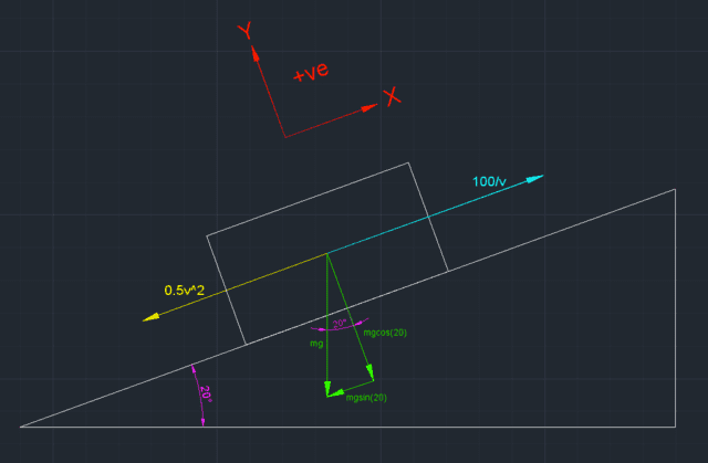

Okay, modeling without air resistance, I'm going to take up the ramp as positive in this case and down the ramp as negative.
[itex] F_x = ma_x [/itex]
[itex] F_x = 100/v - mgsin(\theta) [/itex]
[itex] 100/v - mgsin(\theta) = ma_x [/itex]
At terminal velocity ax = 0.
[itex] 100/v = mgsin(\theta) [/itex]
[itex] v = 100/mgsin(\theta) = 100/(10*9.81*sin(20°) = 2.98 m/s[/itex] (up the ramp)
This is my interpretation of the system:
Beautiful picture :smile:, and yes, I get 2.98 m/s as well.

So that was w/o air resistance, this is with air resistance:
[itex] F_x = 100/v - mgsin(\theta)-0.5v^2 [/itex]
[itex] 100/v - mgsin(\theta)-0.5v^2 = ma_x [/itex]
[itex] 100/v - 0.5v^2 = mgsin(\theta) [/itex]
[itex] 100/v - 0.5v^2 = 10*9.81*sin(20°) [/itex]
Using a solver to solve this equation, yields:
v = 2.69 m/s and like you said should be smaller than without the resistance which was 2.98 m/s!
Well done ! Same outcome here.
