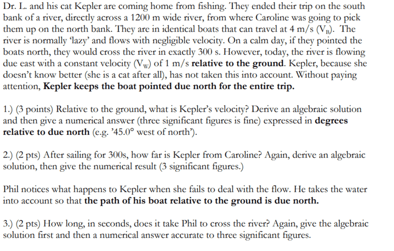

Problem: Dr. L and his cat Kepler are coming home from fishing. They ended their trip on the south bank of a river, directly across a 1200 m wide river, from where Caroline was going to pick them up on the north bank. They are in identical boats that can travel at 4 m/s (Vb). The river is normally 'lazy' and flows with negligible velocity. On a calm day, if they pointed the boats north, they would cross the river in exactly 300 s. However, today the river is flowing due east with a constant velocity (Vw) of 1 m/s relative to the ground. Kepler, keeps the boat pointed due north for the entire trip.
*Phil notices what happened to Kepler when she fails to deal with the flow. He takes the water into account so that the path of his boat relative to the ground is due north. How long does it take Phil to cross the rover?
Hello all, so my problem is with part 3, where it asks how long it takes for Phil to cross the river when he takes into account the current of the river (1 m/s East). I think what needs to be done is a calculation for Phil's velocity but I'm not sure how to go about this. So the problem says the boat can go 4 m/s (Vb), and I'm not sure how to configure the vectors to find the resultant velocity. I keep getting a setup like that I did in part one to find the cats velocity when it doesn't take into account the flow of water.
I have attached images of the problem, my solution for part 1, and my attempt at part 3.
Any help would be greatly appreciated!
P.S. I would love some tips on how to organize and label variables as I struggle with that.

Let ##v_x## represent the x component of Phil's velocity relative to the flowing water, and ##v_y## represent the y component of Phil's velocity relative to the flowing water. If Phil's actual velocity relative to the ground is zero (his boat is moving due North), what is the value of ##v_x##? Since the magnitude of his total velocity relative to the flowing water is 4 m/s, what is the value of ##v_y##? Is this also equal to his velocity in the y direction relative to the ground?
vx would be -1, I'm thinking because that would cancel out with the velocity of the current. I would also think that the x component of his velocity relative to the water and the ground would be the same because there is no velocity in the y direction from the water. The thing that confuses me, that if vx does equal -1, wouldn't that just cancel out the velocity from the water?
Thanks!

Here's my take on this:
Velocity of water flow relative to ground = ##(1)\mathbf{i_x}##
Velocity of boat relative to flowing water = ##v_x\mathbf{i_x}+v_y\mathbf{i_y}##, where ##\sqrt{(v_x)^2+(v_y)^2}=4##
Velocity of boat relative to ground = (velocity of water flow relative to ground) + (velocity of boat relative to flowing water) = ##(v_x+1)\mathbf{i_x}+v_y\mathbf{i_y}##
Since boat is moving exclusively in the y direction relative to the ground (directly across the river), ##(v_x+1)=0##, or ##v_x=-1##. Then ##\sqrt{(-1)^2+(v_y)^2}=4##. Or, ##v_y=\sqrt{4^2-(-1)^2}=\sqrt{15}=3.873##
