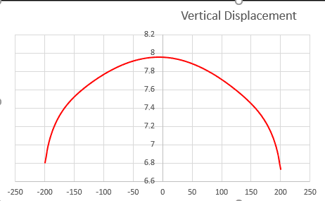

I'm still trying to fathom what you were asking about in your previous thread .
Why don't you just tell us in simple words and pictures what you are trying to do overall in this project ?
Okay, I'll try my best - I've got an FEA model where I apply a heat load to a beam and simulate the thermal expansion. After that, I apply a couple and bend the beam back in another step of the simulation. Often times I will plot the displacement of the top center line of the beam after heat deformation and after subsequent bending.
Right now, I can get the model to agree pretty well with an analytical solution - Ideally, I would like to be able to take this top center line of displacement data after heat deformation - and then use that data to analytically apply the couple(with moments C_1 and C_2) and then match this precisely with my FEA models.
Right now - I add the heat displacement data to the "bending" displacement values that I get from the above equation. This matches decently with the FEA but not perfectly because the above equation is bending an undeformed beam whereas the model takes the deformed beam and then bends it.
Please let me know if you have any more questions and thanks for the follow-up.

Ok . That is a lot clearer now .
This plot from your earlier post is representative of the magnitude of deflections that you are getting ? If so the centre point deflection is only about 0.3% of the beam length ?
