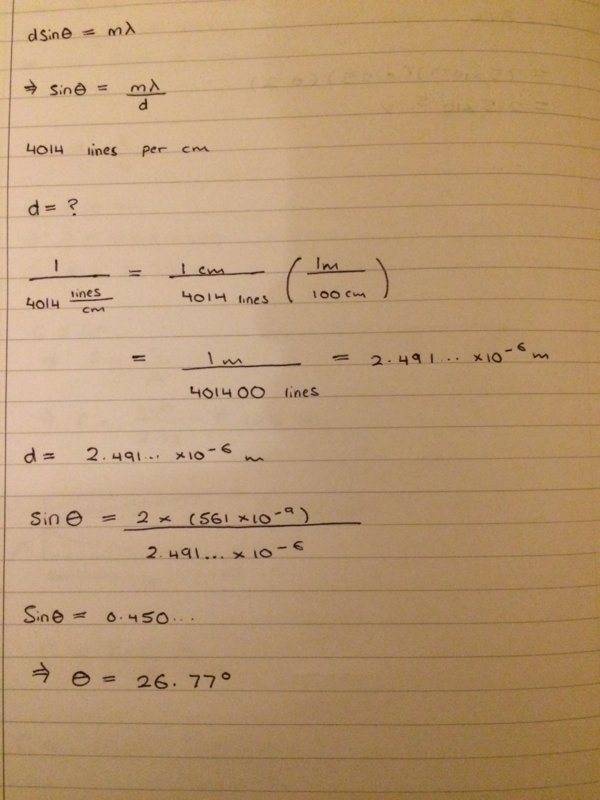

See image attached below
dsin(theta) = m*lambda
Here is my problem
I have given this a go and get 26.77 degrees as my angular position
My concern is do I double this angle to get the angular width between both 2nd order maxima's (which would be 53.53 degrees) or do I just leave it as 26.77 degrees?
Thanks for any help!
Looks good. I believe they are asking for the angle between the central max and either of the 2nd order maxima.
