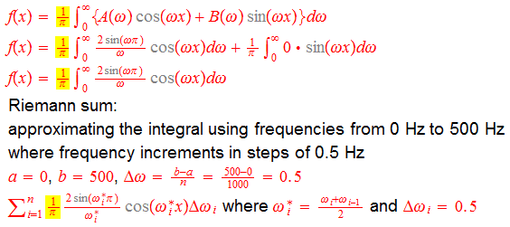

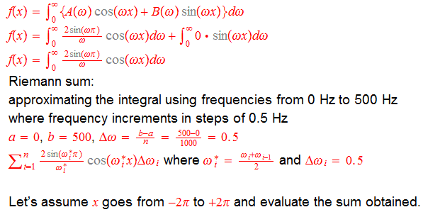

Hi,
Although I'm using trigonometric form of Fourier transform, first I'd discuss both, exponential and trigonometric forms, for the sake of context.
Now proceeding toward the main question and we would only be using trigonometric form.

I understand that the code above involves many iterations so to simplify it just to see if it works, I reduced the number of iterations. It doesn't work. I have include the errors at the bottom. Could you please help me to fix the code? Thank you!

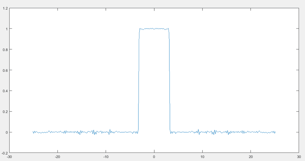

Thank you for your attempt to help me!
I didn't apply any of the debugging and don't have any experience with it either. Sadly, I only use MATLAB when I don't see any other way and only use it quite rarely.
I was able to trace the problem. The main problem was with the lines such as "w_mid=zeros(50);". I was under the impression that it creates a row vector with zero values but it actually generates a matrix.
Also, we also need to use the factor of 1/π and in my first post I did't even mention it. I have updated the code. Without the factor of 1/π, the pulse height was close to "3" when it should have been just "1".

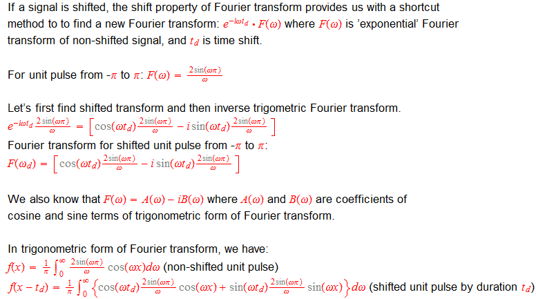

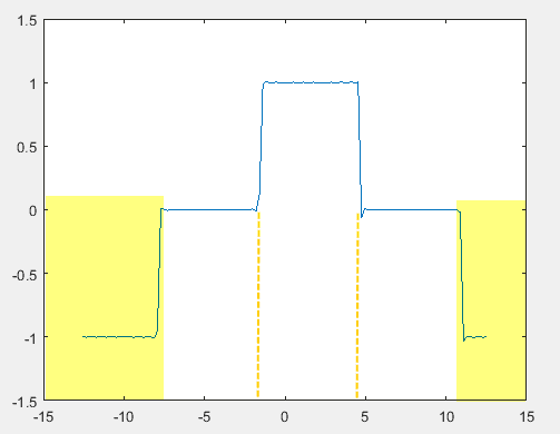

Hi again,
I was trying to apply the approach of approximation using Riemaan sum to a shifted unit pulse by π/2. It looks like I'm doing the math right but there is a problem with the plot at bottom.
In the following code, I'm using frequencies from 0 Hz to 100 Hz using increments of 0.5 Hz, dividing the x-axis into 120 points from -4π to 4π. The rest of code is same as in my previous post.
Matlab:
% file name shifted_fourier_transform_unit_pulse_2.m
% for riemann sum: https://www.math.hmc.edu/calculus/tutorials/riemann_sums/gif/figure3.gif
% using shift of x=t=pi/2
clear all; close all; clc;
Dw=0.5;
w=0.*[0:0.5:100];
x=linspace(-4*pi,4*pi,120);
Rs_x=0.*[1:120];
for i1=1:120
    w_mid=0.*[1:200];
    Rs=0.*[1:200];
    w(1)=0;
    w(2)=0.5;
    for i=1:200
    w_mid(i)=(w(i+1) + w(i))/2; %w_mid(1) is first middle point
    Rs(i)=(1/pi)*((cos((pi/2)*w_mid(i))*(2*sin(pi*w_mid(i))/w_mid(i))*cos(x(i1)*w_mid(i)))+(sin((pi/2)*w_mid(i))*(2*sin(pi*w_mid(i))/w_mid(i))*(sin(x(i1)*w_mid(i)))))*Dw;
    w(i+2)=w(i+1) + Dw;
    end
Rs_x(i1)=sum(Rs);
end
plot(x,Rs_x);
hold;

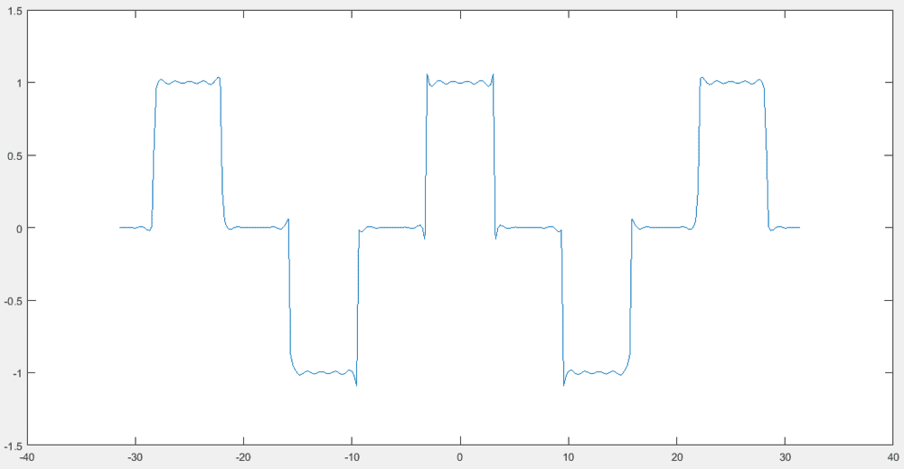

You can see in the plot below that the unit pulse is okay but I don't understand why it falls down to "-1" in the yellow regions. It should have stayed zero everywhere except from -1.57 to 4.7 (or, -π + π/2 to π + π/2) on the x-axis. Could you please help me with that? Where am I having it wrong? Thank you!

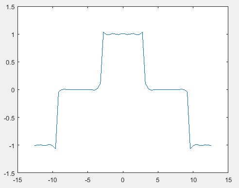

Hi again,
I was trying to fix the problem from my previous posting about the value falling to "-1". While doing this, I tried to see if the same problem happens with the code posted in post #3 for the un-shifted pulse. The same problem happens when I changed the limits for x. The plot is shown below.
Line #8 from the original code.
Matlab:
x=linspace(-2*pi,2*pi,60);
changed to
Matlab:
x=linspace(-4*pi,4*pi,60);
Then, I changed the following two lines from the same code of post #3 to see a larger picture of what was happening over an extended range of x values.
Line numbers #8 and #9 from the original code.
Matlab:
Rs_x=0.*[1:60];
changed to
Matlab:
x=linspace(-10*pi,10*pi,300);
Rs_x=0.*[1:300];
The plot below shows what I got. It gave rise to more questions. The plot seems to represent more of an inverse Fourier series! In Fourier transform, the assumption is made that the period is at infinity therefore there should have only been a single pulse and no other repetitions until we get to the infinity. In other words, it should have only been "1" from -π to π and everywhere else it should have been "0".
I'd really appreciate you could guide me where I'm going wrong. It's more about math now.
I also tried to see if something was wrong with the inverse Fourier transform integral,
, using numerical integration. It looks like integral is good.

PS:
I believe that it has to do something with the value of Δω being used in the code for Riemann sum approximation; in the code Δω is represented as Dw. As the value of Dw is decreased, the period becomes larger; which would mean that as Dw goes to zero, the period becomes infinite. But I have not been able to understand how the value of Δω or Dw is affecting this behavior.
code: https://imagizer.imageshack.com/img921/8572/OaEQzV.jpg
plot: https://imagizer.imageshack.com/img923/5892/KYny42.jpg
code: https://imagizer.imageshack.com/img921/6286/2I99PH.jpg
plot: https://imagizer.imageshack.com/img924/4611/I99GMQ.jpg

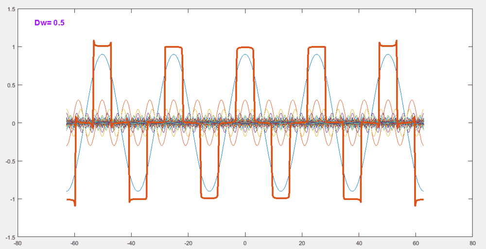

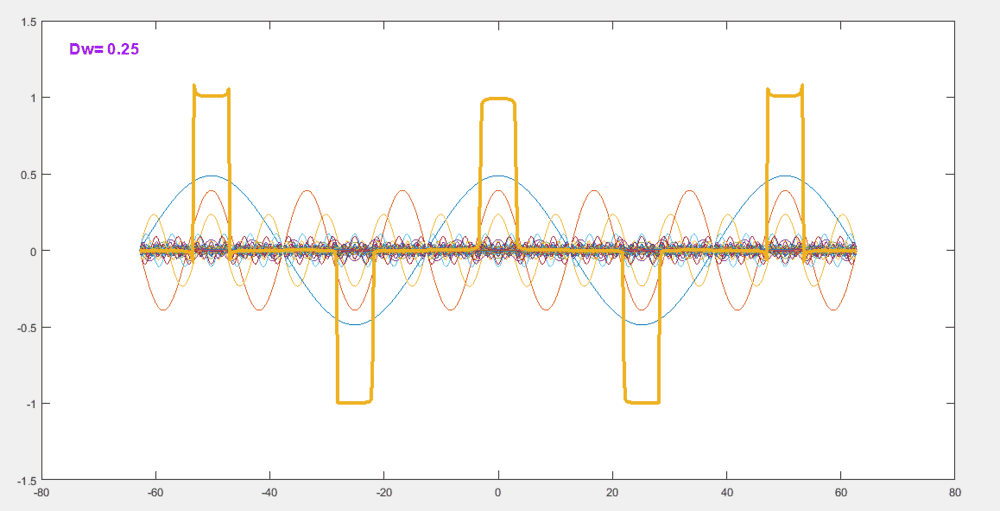

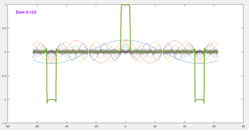

Hi again,
I have been trying to get over this confusion that why Riemann sum approximation to inverse trigonometric Fourier transform becomes inaccurate as the range of 'x' values is extended.
Toward the end of previous post, I had concluded that it had to do something with the value of Δω or Dw being used.
In the code below, "%%" means that the line has a variable which could be changed, or when you change a certain variable, try to go through these lines to see if any changes are needed. The three plots shown under the code were generated by changing value of Dw. In first plot, Dw=0.5, the first jump to "-1" occur around x=-10 and x=10. In second plot, Dw=0.25, the first jump to "-1" occur around x=-22 and x=22. In third plot, Dw=0.125, the first jump to "-1" occur around x=-47 and x=47. It clearly shows that it's the value of Dw which is causing this "jumping to -1" behavior. As the value of Dw becomes smaller, the jump occurs farther away.
Matlab:
% file name "unit_pulse_fourier_transform_riemann_sum_plotting_sinusoids.m"
In the code below inverse Fourier transform of unit pulse is found using
trigometric form of Fourier transform. The integral is approximated using Riemann sum.
Each sinusoid is plotted and then all the sinusoids are added to to plot an appeoximate pulse
Dw=0.5; %% you can change this value
max_freq_used=25; %% you can change this value
w=0.*[0:0.5:max_freq_used];
w_mid_max=max_freq_used/Dw;
w_mid=0.*[1:w_mid_max];
w(1)=0;
w(2)=Dw;
x=linspace(-20*pi,20*pi,500); %% you can change this value
y_values=zeros(w_mid_max,500); %%(max value of w_mid,number of total x intervals)for i1=1:w_mid_max   % max value of index is based on max w_midRs=0.*[1:500]; %%[1:number of x intervals]
w_mid(i1)=(w(i1+1) + w(i1))/2; %w_mid(1) is first middle point    for i=1:500 %% total number of x intervals
    Rs(i)=(1/pi)*(2*sin(pi*w_mid(i1))/w_mid(i1))*cos(x(i)*w_mid(i1))*Dw;
    y_values(i1,i)=Rs(i);
    end
plot(x,Rs);
hold on;
w(i1+2)=w(i1+1) + Dw;
end
z=sum(y_values);
plot(x,z,'linewidth',3);
hold;
Plot #1
Plot #2
Plot #3
Let's see why Dw is affecting this behavior. In Plot #3, the blue sinusoid is the one we start with and w_mid=(0+0.125)/2=0.0625. In other words, 2πf=0.0625 ⇒ f=0.00995 Hz ⇒ T=100.5. If we look closely at the blue sinusoid, it's period is actually 100 units. Think what would the period be if the frequency was, say, f=0.0000000000000000001 Hz?! The period would become almost infinite. In actual inverse Fourier transform, you have frequencies smaller than that! Also, if the period is, say, 100 units, it means for 50 units the sinusoid is going to be positive and for the next 50 units sinusoid is going to be negative. Therefore, when the period is infinite, these positive and negative half cycles would stretch over infinite number of units.
While using Riemann sum to approximate inverse Fourier transform, we increase the frequency using increments, for example in case of Dw=0.125, w_mid1=0.0625 (f=0.00995 Hz) then w_mid2=0.1875 (f=0.02984 Hz), then w_mid3=0.3125 (f=0.04974 Hz) and so on.
Let's look at the integral again
. In yellow we have a sinc function which gives the amplitude for cosine sinusoid whose frequency could vary from 0 to ∞. Remember in trigonometric form Fourier transform we only use positive frequencies. The code below could be used to plot sinc function. The plot is also shown. From the plot, we can see that the amplitude is maximum for ω cyclic frequencies between 0 < ω < 1. But in case of Riemann sum, we are only using increments which make us miss many 'important frequencies' between 0 < ω < 1. Further, think of a cos(ωx)=cos(2πf*x) where f=0.0000000000000000001 Hz,for such a sinusoid cosine is going to be positive or we can say its positive cycle is going to stretch over an infinite number of units. Using increments have us miss many such cosines whose positive half cycles extend over very, very large duration like a'positive' ceiling.
Note that for cos{2π(1)*x}, its positive half cycle extends over 0.5 units and its total period is 1 unit.
We can say that Riemann sum is good for integration and as a general approximate for area but when it is used to approximate inverse Fourier transform, it results into missing many important frequencies whose weightage or importance is way more compared to the other frequencies.

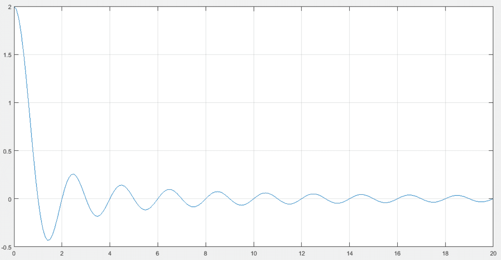

Matlab:
clc; clear all; close all;
w=[0:0.1:20];
for i=1:201
    if w(i)==0
    sinc(i)=2;
    continue
    end
sinc(i)=2*sin(w(i)*pi)/(w(i)*pi);
end
plot(w,sinc);
grid on;
hold;
