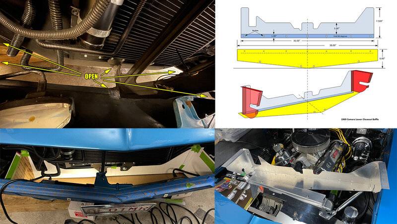

A while back, you guys helped me out with a project on my '69 Camaro. It was all about the Bernoulli principle and airflow taking the path of least resistance. I'm happy to say that the lower closeout panel I built (see pix below) seems to have done the trick as the car I no longer having any sort of overheating issues. I did install a more powerful single 19" fan to replace the two 12" ones and that put it over the top. And that's the basis for my new post... CFM.

In the close quarters of the radiator/shroud/fan assembly I still have this nagging thought that two 1750 CFM fans will pull more air through the radiator than the single 1750 CFM fan because they would have shorter distances from the fan blades to the edges of the core and therefore promote better cooling. But everything is relative, and if the 17" fan had a more powerful motor and was rated at 4000 CFM it would obviously be the winner. There's so many variables in this theoretical discussion that its hard to conclude anything LOL. So here's a crude diagrams showing the comparison.
