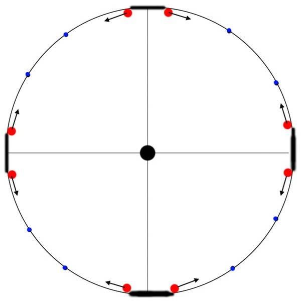

Hello everyone, i m working on a full circle space centrifuge concept. I try to support it with some maths but i don't want to dive into crazy details. I used alrdy lot of countermeasures to dangerous effects.I have problems similar to bridge mechanics. The design is not solid so i need to be careful about many things.
The shape of my concept looks like a big cross (made our of wire ) on each end of the cross we have solid pieces metallic platforms, while 2 parallel circles of wire connecting the 4 platforms via "bridges". In the center we have a central hub. Hopefully this 4 bridges will be real solid bridges at some point.
The type of wires i picked is almost random, but I am trying to use some true characteristics like brake point.
My first problem was to understand how strong is my bridges.With help from forum i found the tensile force of a rotating full circle, and a second approach how much weight i can put per some x distance when the shape converts to an Ngon. So i produced some safety limits for example 300 Kg per meter of bridge at 0.1654 G.
But in reality there are no full circles of wire, platforms getting in between every 45 deg isolating bridge wires into arcs<45 deg does that affect limits?.
Also at the start of p2 the bridges are almost empty, and i was thinking of 8 vehicles that could start using the wires as a railroad, to distribute, materials symmetrically, but if something heavy steps on a bridge the shape changes only i don't know how.For now, this is the main question that bothers me, how the shape of bridges will change with distribution of materials. Can somebody guide my how i can simplify this problem.
And btw since i want to end with a solid and rigid full circle i want to distribute space-frame materials. Any suggestions have you heard anything similar space frame based on wires? For space it should be something lightweight and strong right?

Heh, that's is why I am here, you guys know much better physics than me, in reality i don't know how to schedule the distribution, to maximize shape preservation. The only good advice i give to my self is keep some basic symmetry. I made a quick shape Here is why i think 8 is like minimum. after that i think of 16.
Red dots robotic vehicles, blue dots first materials distributed. Each robot steps on 2 wires, and can move back and fourth to get mats from platforms, and can run over obstacles. I am open to any suggestions. I understand that is hard to calculate the new shape after distribution.

Hello Everyone i did a simulation and want to show you an interesting visual, for discuss.
One "weird" aspect of the Artificial Gravity is that: it increases linear with the radius.
I call this "Weird Gravity" (WG). It sound not a big problem in the start.
Bellow is a snapshot from a simulation that i did, in a 3D app.
DOS: Direction of spinning, Green curve: original radius(perfect circle), Grey fat curve: Deformed shape of the actual cable. Deformed cable with a sense of red line in it : Sank`d part(right), Cable with a sense of blue line in it raised part(left).
As you can see the image only focuses in a quarter of the construct. This in one cable actually between 2 platforms fixed in radius r, i call this bridge.
I find out earlier that even super gentle torque (towards DOS) in the entire construct via platforms, can cause same type of deformation only stronger.
However this snapshot is taken after long time in uniform circular motion after small increase in rpm. So the bridge cable had all the time to find equilibrium in a different shape. But it never came back completely to the original shape which is a perfect circle with radius r.
A serious candidate for what causes this permanent deformation is the "WG". There is also a small chance that the simulation involves an atmosphere by default that could make this effect more sustainable but i`m not sure if that is the case.
So i want to ask your opinion, can that deformation be sustainable, only by the nature of Artificial Gravity?
Or the cable has to come back in the green curve (perfect circle) when construct falls back to uniform circular motion?
