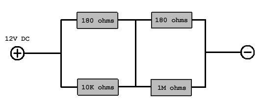

Note: this isn't an actual problem from a textbook; it is something that I've been wondering about because I was never taught how to do this in school or in my physics textbook.
In this very basic circuit, how do you determine the direction and value of current through each resistor and through the vertical connection between the two parallel branches?
If it weren't for the connection between the two branches, you would combine each series pair of resistors, and then use I=V/R to determine the current through each branch. But when the parallel branches are connected like this, how do you determine current direction and value? Thanks.

Suppose there were a resistor connecting the middle of the two branches instead of just a (zero ohm) wire? Would you know how to solve the circuit then?
I ask because there is more than one way to solve this problem, and the choice of a method might depend on your level of knowledge of network solution techniques.

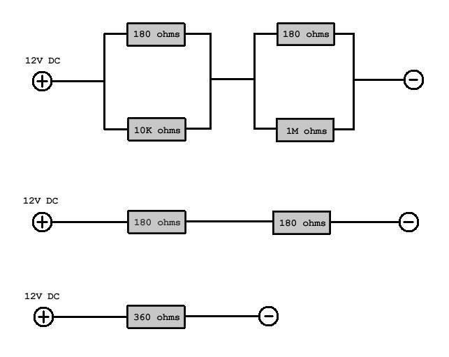

Hmmm. If you refer to the figure, you can find two pair of resistors in parallel are in series, and each pair can be reduced to single resistance, so that you will be left with two resistors in series. Now you can simply add these resistances and find the total current.
Hope you know how to find current through individual resistors.
Okay - I think you mean it can be simplified like this:
1) separate it into two parallel combinations in series with each other (top)
2) simplify each parallel combination into single approximate values using the formula 1/Rparallel = 1/R1 + 1/R2 , which comes to approx. 180 ohms each (middle)
3) add the two series resistances together to get a single effective resistance of the circuit of approximately 360 ohms (bottom)
Is this correct so far? Electrician - I'll answer your question but first I need to know if I'm on the right track so far.

Yeah, you are right with your answers. Once you know the total current flowing, you can find currents through individual resistors in parallel.

Okay, the total current = V/Rtotal = 12/360 = 0.0333A or 33.3mA. To find the current through each resistor you must first find the voltage drop across each of the two parallel combinations using deltaV = IR. So the voltage drop across both parallel combinations rounds to approx 6V each (if I had used more decimal places or smaller units I could've been more precise). And each 180ohm resistor passes almost the full 0.0333A while the other two pass very little (again, rounded off). I think this is correct - if not let me know.
This is correct.

Here's a method to solve the problem with the 1000 ohm resistor, or with just a wire in that position:
http://kauko.hallikainen.org/rw/theory/theory6.html
Does that answer your original question?
