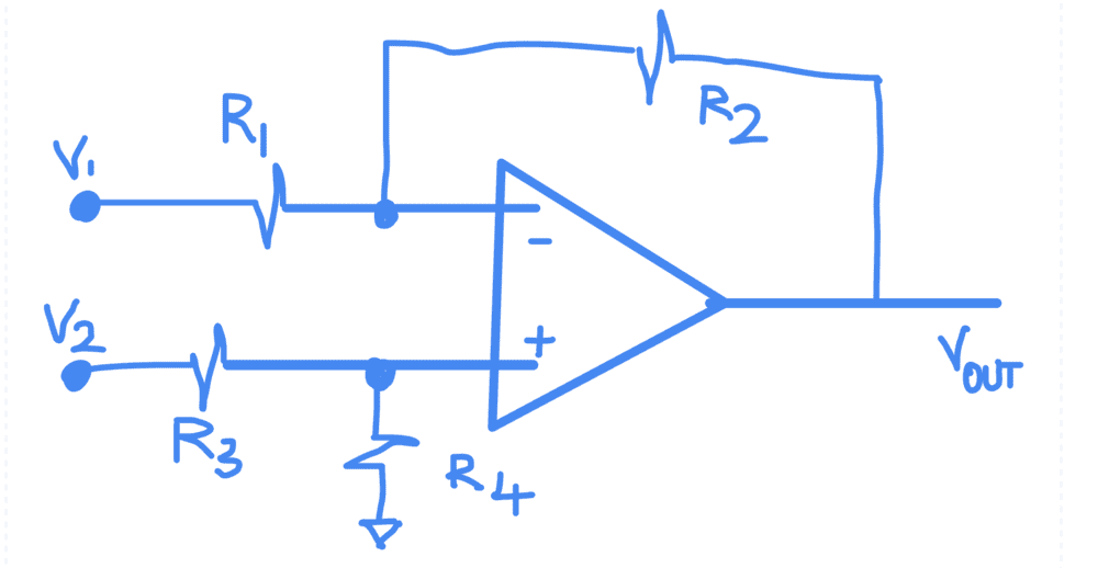

I need to design an operational amplifier that performs the operation ##V_{output} = 3V_1 - 2V_2##.
I realise that a difference amplifier must be used to construct this. Thus the relevant equation is :
v_{o u t}=v_{2} *\left(\frac{R_{4}}{R_{3}+R_{4}}\right) *\left(1+\frac{R_{2}}{R_{1}}\right)-v_{1} *\left(\frac{R_{2}}{R_{1}}\right)##
Here I let ##R_2 = 2 ## kohms and ##R_1 = 1## kohms. Using this suggests that ##R_3 = 0## and ## R_4 = 1 ## kohms (?!)
The resulting circuit is
Is this the correct way to solve this?
PS : I just realized that I have interchanged ##V_1## and ## V_2## in the diagram!
You can directly connect V1 to the non-inverting input. No need to use the R3-R4 voltage divider.
Rest of your solution looks correct to me.

I've had to design similar circuits many times in the real world. The most common implementation is when you want some gain for a signal and an additional offset. In that case the "other" input is a reference voltage.
This is a great place to use the superposition of linear circuits. There is a necessary gain from V2 to the output, which can be found by setting V1=0 (so those resistors don't matter). Then you look only at the gain you need from V1 to the output, through the gain term defined by the Vo/V2 solution; so set V2=0 and solve for Vo/V1.

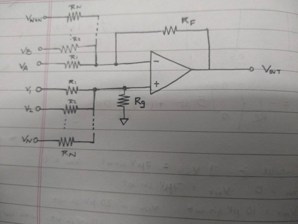

Another question : Would the circuit I have drawn about help if a circuit involving both summing and differences had to be created (##V_{output} = (xV_A + yV_B + ... + zV_{N+N} ) - (aV_1 + bV_2 + ... + nV_N)## ?
First you need Rf = Rg for this to be a diff amp.
Then the way I would use superposition would be to set all but one of the inputs to zero. That doesn't remove those inputs, it just connects those resistors to ground. An open input does remove the connected resistor and needs to be done in pairs with it's mate.

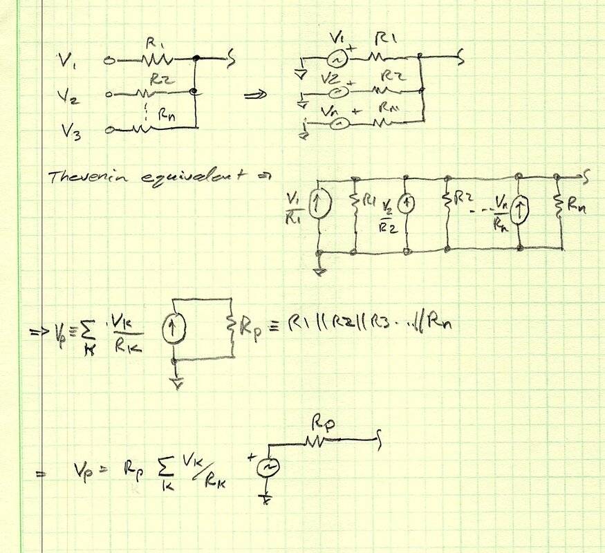

I'll let you try the derivation first (since I'm a bit lazy) ask me if you run into trouble. The key to it is combining the inputs as shown in the photo. You can do it with KVL/KCL too but I think Thevenin is easier.
Finally, the answer: First define Rp as the parallel combination of all resistors connected to the inputs (R1||R2||R3...||Rn). This doesn't appear in the final equation because the resistive divider effect at the input is canceled by the gain increase from the feedback reduction.
Then the gain for any single input pair "k" (all inputs are applied as differential pairs, even if one side is 0) is Rf/Rk. Then you can add in as many inputs as you like, e.g Vo=Rf/R1(V1-Va)+Rf/R2(V2-Vb)+...
I'll have a go at the derivation asap but could you tell me why Rf = Rg for it to be a diff amp?

It part of the requirement to have balanced (the same) gain for the positive and negative inputs. Look at your "relevant equation" in the original post and find the positive gain when R4/R3 = R2/R1 (people often satisfy this by making R3=R1 and R4=R2).
