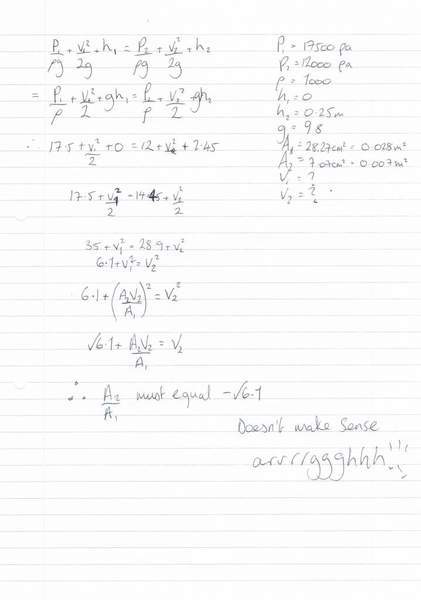

Hi all I'm trying to teach myself a bit of bernoulli's principle but i am struggling.
I'm pretty sure I need to use a combination of bernies equation and continuity equation but I get lost when trying to rearrange to find velocity.
Water moves through a constricted pipe in steady, ideal
flow. At the lower point, the pressure
is P1 17500 Pa and the pipe diameter is 6.00 cm.
At another point y 0.250 m higher, the pressure is P2 12000 Pa and the pipe diameter is 3.00 cm. Find the speed of flow (a) in the lower section and (b) in the upper
section. (c) Find the volume flow rate through the pipe.
P1/ρg+v^2/2g+y1 = P2/ρg+v^2/2g+y2
A1v1=A2v2
Information I have is
P1= 17500 Pa
P2= 12000 Pa
Y1= 0
Y2= 0.25m
A1= 0.0028 m2
A2= 0.00071 m2
I need to find v1 and v2 and volume flow rate
I know buy using the the continuity equation I can substitute the valve of v1 for v2,
but when I come to rearranging the formula it becomes a mess. I have searched online but lots of examples tend to skip important steps and just show the final equation.
I would like to know step by step how to do it. (please note that it has been nearly 20 years since I last did maths :redface:)

So I've had a go and I must be making a simple mistake somewhere but can't see it. see attached sheet.

Your algebra is OK when you reach this line:
6.1 + ((A2/A1)*V2)^2 = V2^2
You can't take the square root of both sides because of the constant factor of 6.1 added to the LHS.
Instead, you must bring the expression for V2 to one side first:
A2/A1 = 0.25, because d2 = (d1)/2
so,
6.1 = (1 - 0.25)*V2^2 = 0.75*V2^2
V2^2 = 6.1/0.75 = 8.13
V2 = SQRT (8.13) = 2.852 m/s
then V1 = 0.25*V2 = 0.713 m/s
Thanks for taking the time to help, but I'm still a bit confused,
these parts i understand
but
on this line where did the 1 come from and where has the other v2^2 gone because when I look at it there is a v2^2 on both lhs and rhs
I see this as
6.1 + (0.25*V2)^2 = V2^2
I got in a hurry and made a small mistake:
which should be
6.1 + 0.0625V2^2 = V2^2
collecting V2 on one side and constants on the other:
6.1 = V2^2 - 0.0625V^2 = (1 - 0.0625)*V2^2 = 0.9375*V2^2
V2^2 = 6.1/0.9375 = 6.507 (m/s)^2
V2 = SQRT (6.507) = 2.551 m/s
V1 = 0.25*V2 = 0.638 m/s
Thank you, i'll be able to sleep well tonight :smile:.
