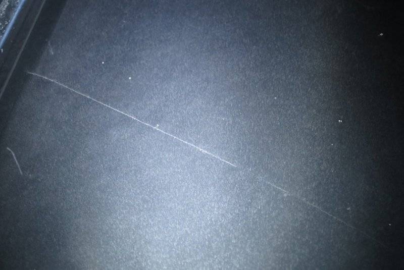

Hello. We are elementary school kids who built a cloud chamber for our science project to test out the effectiveness of different shields against background radiation. We are not sure about something involving beta-particles. Can you help us please?
We know low-energy beta particles cannot penetrate the glass of our fish tank chamber, so they must already be present in the air trapped inside our chamber...but what about high-energy beta particles? We think we are seeing some medium length, bending particles (not muons) entering our chamber from the outside that look like high-energy betas. Is that possible?

How thick is the glass? Why so you think they come from outside?

How thick is the glass? Why so you think they come from outside?The glass is 3mm thick. Some particles also seem to be coming through the metal base of the fish tank.
We think some particles besides muons are coming from outside the tank because of tracks like the middle particle in the photo we're attaching. Video shows that the track began from behind or on the glass. The track was short and curled a little at the end, so we don't think it was a muon.

Also, do you think this other track is a muon with a delta ray, or something else?
On the glass sounds much more plausible than behind.
The last one looks like a muon, although the angle is unusual.

Some high-energetic electrons can pass the glass, but where do you expect a strong emitter outside?

The only particles from cosmic rays that make it to the ground (in relevant amounts) are muons. Their decays produce a few high-energetic electrons, but those are rare. The remaining activity comes from the natural activity of all the materials in the cloud chamber.

Well, you can have some secondary effects: the electrons (and also the muons) can hit nuclei and accelerate/split them, and so on. I don't have numbers for the relative fractions, and it also depends on the level of radioactivity and the place of the detector. At sea level, you have about 1 muon per second and square decimeter. Compare this to the number of tracks you see.
