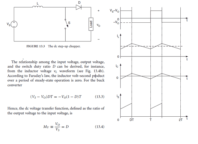

Hi,
I'm studying Choppers and I'm struggling with derivation of Buck Converter.
As per equation 13.3 if I solve it ahead I get
Vs D T - Vo D T = - Vo T + Vo D T
Solving this ahead I get
Vs (D T ) = Vo (-T + DT + DT)
Vs (DT) = Vo(2DT - T)
Vs D = Vo (2D - 1)
Vo / Vs = D/(2D - 1)
Not sure how to go ahead from here to reach equation 13.4

There is an error in 13.3. There is no minus sign in front of the Vo on the right-hand side.
You can catch these kinds of errors by visualizing what the equations are telling us physically.
But the graph also has - Vo.
Physically area means integrating of V and t.
The areas are equal. You can sum them to zero, one contributing positive, the other contributing negative. If they are on opposite sides of the equal sign they will both share the same sign (otherwise they aren't equal).

Thus: (Vs - Vo)Ton = Vo(Toff)
But why V times T and why not V2? Energy is proportional to Voltage square divide by resistance times time.

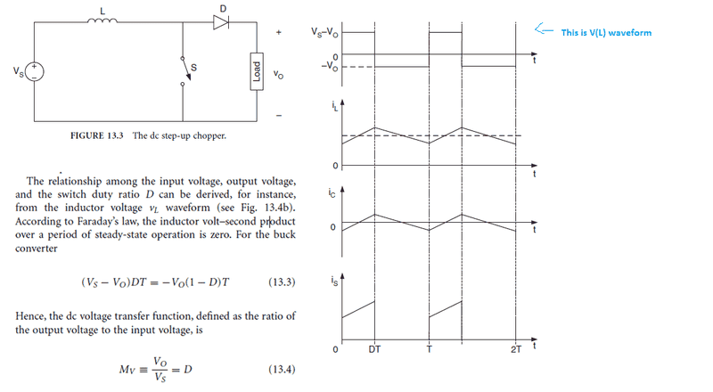

So in steady state, the average inductor voltage is zero. Which means that the sum of the red area + the blue area is zero i.e. $$V_L = \frac{1}{T_s}\int_0^{T_s}v_L(t)dt = 0 $$
Solving the integral we get, which is easy if you look at the figure below:
$$\underbrace{(V_s-V_o)DT_s}_{\text{red area}}+\underbrace{(-V_0)(1-D)T_s}_{\text{blue area}} = 0$$
Then solving as you did in post #1 yields eq. 13.4.

Just a correction to my post #8, second equation, should be: $$\frac{1}{T_s}\left[(V_s-V_o)DT_s + (-V_o)(1-D)T_s\right]$$ and not $$(V_s-V_o)DT_s+ (-V_o)(1-D)T_s$$
