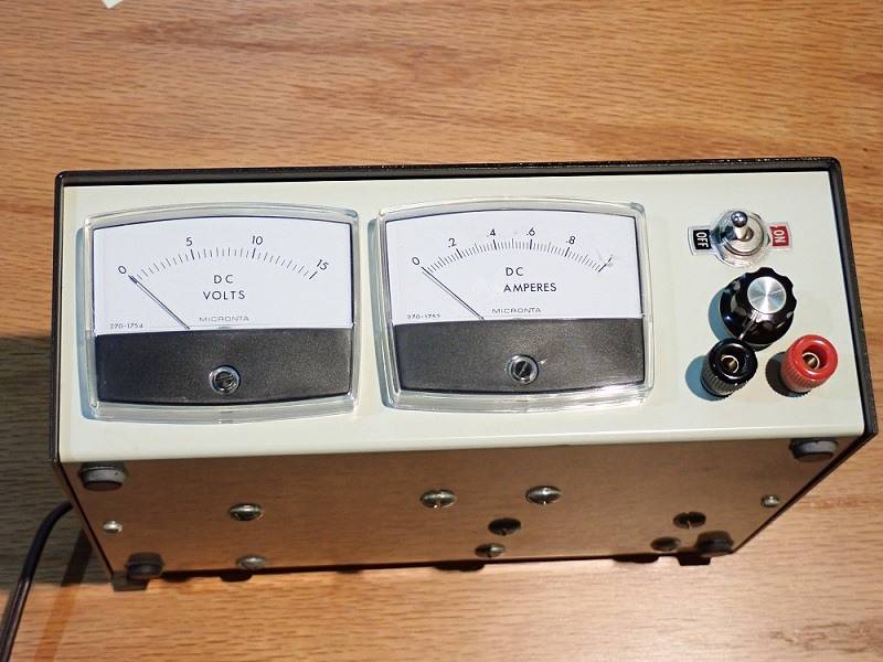

This is my 1 to 12 volt power supply that I built back when. The ammeter is a one milliamp meter with a shunt resistor made from a piece of copper wire to make it a one amp meter, and the "milli" painted over.
A voltmeter is a low current meter with a series resistor. And a resistance meter is a voltage source in series with a current meter, a series resistor to set the range, and the unknown resistance. You should be able to do the necessary calculations to find the correct resistors.
Hint: You can get almost any resistance by connecting two or three resistors in some combination of series and parallel.
And, yes I was aware of the TCR of copper at the time, but felt at the time that a copper shunt would be good enough. And it has been, and still is, good enough.
