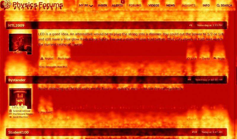

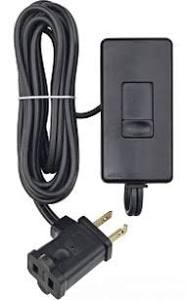

LED is a good idea. An alternative would be to plug the string into a dimmer. You could cut the power to 1/2 or 1/4 and still have a nice glow from those lights. I've put a diode in one lead before. That cuts power in half. Just watch the current rating of course.
