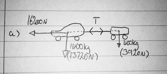

Start with a free body diagram.
Thanks, I have done that but this is as far as I can get before becoming stuck!
Write down the force balance equation for the trailer. Also, in your free body diagram, you are missing a force between the ground and the car.

Hi, thanks again for the help! I have added in a friction arrow for the car and one for the trailer (not sure how I forgot that!) but I'm not sure what you mean about a for balance equation for the trailer?

It is unnecessary to include a friction arrow for the trailer because its tires are not driven; they are just idling. But including a friction arrow for the force the road exerts on the car is important. Which direction do you think this arrow is pointing?
Getting back to the trailer, if you focus on the trailer as a free body, what is(are) the horizontal force(s) acting on it?

I see, I have the arrow for the friction under the car pointing towards the trailer. As for the trailer, I think the forces acting on it are simply its weight due to gravity and the tension between the trailer and the car given that friction is unnecessary, is that right?

A car engine is not a jet engine. If there were no friction between tyres and road, would the car go?
In your diagram, you show a forward force propelling the car, but there are two things wrong with it. It has the wrong value (it takes 60s to reach 9m/s) and it is drawn in the wrong place.

This is not correct. As haruspex was alluding to in the previous post, the frictional force exerted by the road on the car tires is pointing forwards, in the direction that the car is moving. The tires are driven by the car engine, and they are pushing backwards on the road surface. The road surface, in turn, is pushing forward on the car. This is where haruspex was saying that the forward arrow should go.
Yes. So, given this information, what is the horizontal force balance on the trailer?
