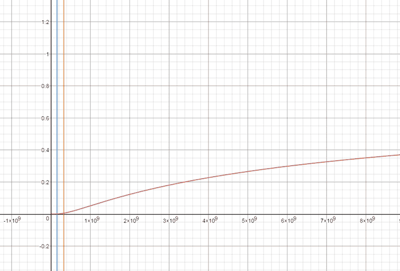

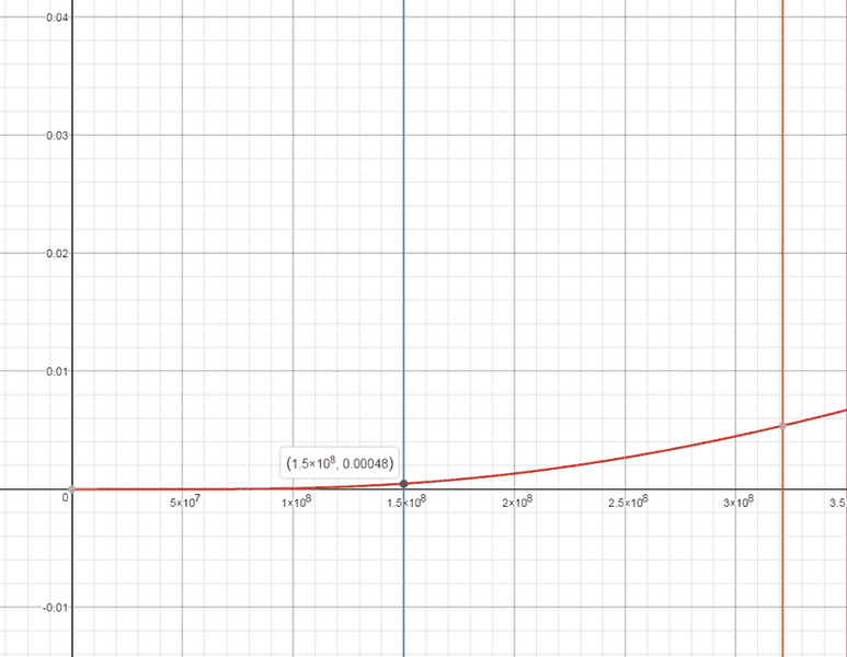

Recently, I have learn't about the Gamows factor, and I have plotted it. Then I realized that the probability of Deuterium and tritium fusing at a temperature of 150 million kelvin when they collide, was about 0.00048. But, I know that the nuclear cross section for fusion is extremely small (about 1-1000 barns). But why is this so? I f the probability of fusion is 0.00048 when they collide, then why is the nuclear cross section so small? Is it because of the collisions? Are the collisions really that rare? Is the collision cross section really that small? Why is the nuclear cross section so small?
  • Here the x-axis is the temperature and the y-axis is the probability of fusion when a collision occurs.
Why do you expect a large cross section? To actually hit the nuclei in a classical sense you would need about 2 MeV - but then you have to hit exactly, which is incredibly unlikely as nuclei are tiny (smaller than 1 barn). Everything below that has the nuclei approach each other, and then you have to hope that they tunnel to fuse before they fly apart again. That process is not very frequent either.
Does the ion-ion collision rate or collision frequency increase or decrease with an increase in temperature? I've read that most plasmas could be considered collisionless or have little collisions taking place.
For a constant density, the collision rate increases with temperature, simply because the particles move faster.
Now, for a plasma put under a constant pressure, the molar density multiplied by the temperature is always a constant which equals Pressure/Gas constant. According to the ideal has equation. So the collision rate is a constant for a constant pressure right?
At constant pressure: double the temperature and you double the path length between collisions, but the speed only grows with a factor sqrt(2) - collisions get less frequent. The chance of fusion increases more up to some point, so increasing temperature is still advisable.
So that's why the cross section drops after 150 million kelvin for D-T fusion? The collisions become less frequent?
The velocity you considered is the average velocity isn't it?
The cross section itself decreases as well if the energy gets too high, this is a more important effect.
