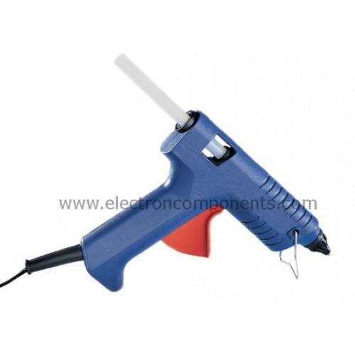

All the hot glue guns I have owned or seen, the nozzle isn't heated . Its just a coned shaped outlet
the heating/melting is done further in, in a cylindrical tube that has a just slightly larger internal diameter than the glue stick
the nozzle just reduces that diameter down to a smaller size to ease in the use of application of the glue

I must have a strange one because the glue stick is pushed into the nozzle which has a heat coil where the nozzle threads into the hot glue gun. I am sure it does not do the bulk of the heat transfer, but now I am just curious.
nothing like this huh ?? ...
there's varieties in shape and manufacture but they all work the same
cold glue stick in the back end, hot melt out the nozzle
http://www.bing.com/images/search?q=hot+glue+guns&FORM=HDRSC2if yours is different, maybe a pic of your one so we all know what you are referring tocheers
Dave
