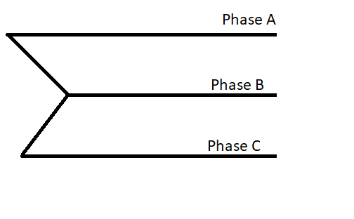

I wish to make a polar plot, showing the current and voltage phasors for each phase (unbalanced 3-phase, 3 wire system (IT system), se picture below.).
I have obtained the following readings (instantaneous values):
  • Phase to phase voltages (U12, U23, U31)
  • phase to ground voltages (U1, U2, U3)
  • currents (i1, i2, i3) I believe these are measured as line currents, so have to divide by sqrt(3) to get the phase currents as my setup is connected in wye config (not grounded).
  • power factor for each phase, so I can calculate the phase difference between the voltage and current phasor.
Based on this readings, how should I go if I want to calculate the voltage and current phasors for each phase, is it possible with this readings?

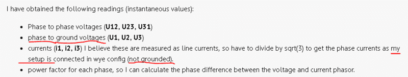

I should have written phase to neutral point, I think(?). I am testing this on a setup that is earthed like an IT system, i.e. the neutral point is not connected to earth. Sorry for not beeing clear, lack of EE/math knowledge is holding me down, but I thought this was a good way to get some more knowledge :)
it's not clear where you took those measurements.
can you draw a sketch (maybe in Paint?) and upload it ?
