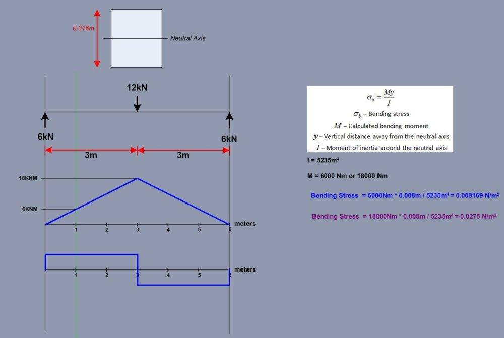

Hello all
I am trying to calculate the bending stress of a simply supported beam with a load of 12kn at the middle of a 6m span, member depth of 0.016m
I have drawn both the bending moment and shear force diagram.
I want to know the following:-
1) When calculating the bending stress would you always use the Max bending moment Or would you use the bending moment at a particular point along the member? below is a sketch:-
As you can see i have calculated the bending stress at 1m along the beam - is it convention to always use the max bending moment at all points along the beam or the actual bending moment at the point along the beam to which your calculating the bending stress for?
As you can see i have 2 answers and i am not sure which is correct?
2) How would you know that the value i get for bending stress is compressive or tensile, i think that i get a positive value which is compressive because i went 0.008m UP my neutral axis which is in compression - would this be correct?
Thank you.
We pretty much always calculate bending stress at a point along the beam where bending moment (and thus also stress) is highest. So in the case of simply supported beam with force in the middle this point will be in the middle of the beam. The formula for bending stress includes vertical distance from neutral axis. Bending stress is maximum in extreme (outer) fibers so we take the distance from neutral axis to points of the cross section farthest away from this axis.
Now when it comes to the sign, in this case stresses above neutral axis will be compressive while those below the neutral axis will be tensile.
