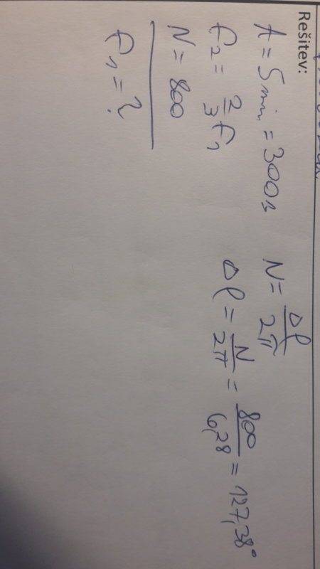

When we stop rotating the flywheel, the rotational frequency drops in 5 minutes to two thirds of its starting frequency, in which time the flywheel does 800 rotations. What is the starting frequency?
None given
I converted 5 minutes to 300 seconds, and movement angle per second as shown on the picture. From here on I am lost, as the angular velocity can't be calculated, as the time given isn't the one in which the flywheel does one rotation.
I apologise if I used any expressions wrong, english is not my mother toungue... :sorry:

So, if I divide the angle i calculated with 300 seconds of time, then I should get average angular velocity? That is what an equation in my notebook says at least.
But consequently this also gives an average frequency, going by the equation w=2×Pi×f (w being angular velocity and f being frequency). Not the initial frequency or the later frequency, as required.

So, two thirds of 160 rpm is 106 rpm. If I multiply that by 5 minutes, that gives me 530 rpm. Is that then rpm of final frequency?

No. You know the average is 160 rpm. And you know that it started at ##x## rpm and it ended at ##2x/3## rpm.
That's the same mathematics as a car that started at ##x \ m/s## ended at ##2x/3 \ m/s## and had an average speed of ##160 m/s## during this time.
Or, it could be any other physical quantity described as a rate per unit of time.
You need to find ##x## where ##160## is half way between ##x## and ##2x/3##.

This is my last attempt. I went by the form or average velocity calculator, so:
Average velocity = (final velocity + initial velocity)/2
I replaced average velocity with 160 rpm, final velocity with 2x/3 and initial velocity with x. I got 192, which i assume is initial velocity. The final velocity is then 2 thirds of that, or 128 rpm.
Can you check that all works out? See above.
I am going to make a guess and say it does. I am solving this example for an entire day, so I am going to thank you for your help and move on. :bow:
