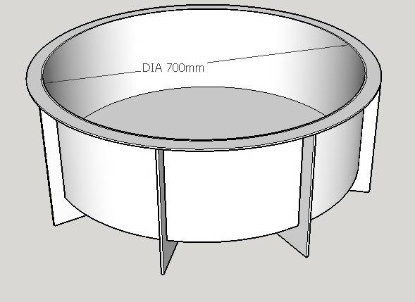

Hi Members,
As described above, I am making a prototype of a vacuum and compression chamber and I could use some help calculating the wall thickness/support structure that is needed to make sure things don’t go boom.

Because I already found 4mm thick stainless steel (304) material for the cylinder and the bottom I decided to start making the following (see image underneath). The prototype of the chamber changed a bit, but the overall idea stayed the same. The cylinder and bottom are already welded together, but I'm waiting for some feedback before I start welding the support structure together.
Knowing the flat areas would be the biggest problem because of the “curving” of the steel I focused on the bottom of the construction first.
I calculated the forces for only the bottom of the construction.
Bottom : π x 35cm² = 3848,45 cm² x 30N/ cm² = 115453,5 Newton of force.
Only the bottom and lid of the construction need to handle a force of roughly 11tons of weight.
I know 4mm of stainless steel simply would not do the job. The chamber needs a steel exoskeleton, welded to the steel to resist the bottom construction of curving. Mainly focusing on the center of the circle, where the “movement” would be the biggest.
I was picturing something like this.
For so far I found a 8mm stainless steel (304) plate that I could use for the exoskeleton.
I do have knowledge about calculations of steel constructions, for example, calculating floor beams or roof construction isn’t a real problem. But this seems to be something slightly different, so I was hoping that someone on this forum could guide me in the right direction to determine the thickness, height and amount of support structure needed.

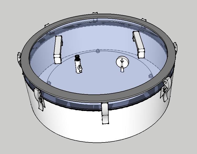

Besides that I was hoping someone could advise me on the thickness and material of the (if possible transparent) lid. I was thinking of Acrylic or Plexiglas. But that depends on the thickness needed (and of course of the price) A other solution would be using a similar structure as for the bottom, but then with an Acrylic or Plexiglas window.

I'm not an expert, so don't rely on what I write:
You cannot ignore the vacuum requirement - over- and underpressure have different failure modes, something that is designed to withstand high pressure can easily fail if you use it with vacuum inside. PET bottles are a simple example. They can handle high internal pressures because no deformation of the material allows to increase the volume inside, but they will fail quickly if you try to evacuate them because they can crumple.
Your exoskeleton looks nice to handle high pressures (when your cover pushes against the skeleton), but can it "hold" the bottom plate (with tension in the connection), too?
Your cover will be pushed against the side walls along the whole circle when you have vacuum inside - it is probably sufficient to consider the internal stiffness of the cover plate. With overpressure inside, your connection points will have to hold it - 115kN distributed over 8 locks?
Thank you for the quick reply.
I was planning to tig weld the skeleton to the cylinder, with a weld on both sides of the structure. In that way the construction should be able to take forces from both sides. (Kind of like a like a steel beam)
The lid will be clamped down using big (threaded) clamps. The ones I am planning to use can take up to roughly 4000kg, let's say 40kN each. So I planned using 6 of them. They will be welded on to the skeleton on one side. And I was planning to use a big metal ring on top of the lid to make sure the clamps keep the top plate in place. (for the pressure) Of course with a decent gasket in between. (rubber or silicone)
