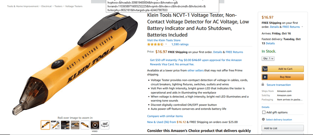

That's a good question. There are two main ways that we do it (I'm not a certified electrician, but I've done lots of that type of work for my homes to code with an EE's eye to safety)...
-1- Disconnect the circuit at the breaker box, and lock it out (with a visual indicator and/or physical lockout)
-2- Use a DVM or non-contact voltage detector to tell if the circuit you are about to work on is energized.
Quiz Question -- How does the small hand-held detector in #2 work?
https://www.amazon.com/dp/B001UAHZAM/?tag=pfamazon01-20
I don't know.

It uses parasitic capacitance from the user's hand and body to Earth ground. It uses a high input impedance voltage detector to capacitively sense 50/60Hz AC voltage. It cannot detect DC voltages, since it is relying on capacitance to "complete" the circuit. It's a very handy tool. :smile:
