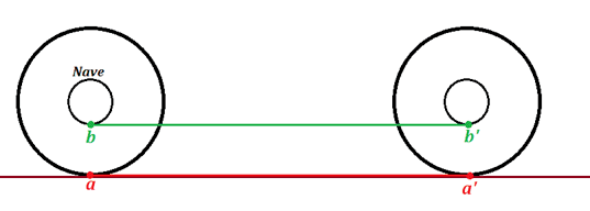

It deals with a paradox about rolling without slipping that apparently goes back to at least Aristotle. Consider a wheel rolling without slipping and the wheel has a hub (or nave). After one revolution, points a and b go to a' and b', respectively. The lengths of lines aa' and bb' are equal. Yet the circumference of the nave is much smaller than the circumference of the rim of the wheel.

My interpretation of the article in the old book: First, it's not about centripetal motion. The books point: consider 'a' as the point of contact between wheel and surface, and 'b' as the point of contact between the nave and an imaginary horizontal plane. At any moment in time, 'a' does not move with respect to the surface, but 'b' has a component of velocity with respect to the surface (to the right in the example from post #5), so 'b' can be considered to be sliding along the imaginary plane, while 'a' is not sliding along the surface.
No frictional force from the ground is required. The wheel could be moving in space, free from any forces, rotating and translating in a manner that would be the equivalent of rolling.
As an analogy, consider a yo-yo moving at constant speed and an infinitely thin string kept taught that wraps under and around the nave (axle), also at constant speed; the string moves to the right with respect to the surface that the yo-yo rolls along.
