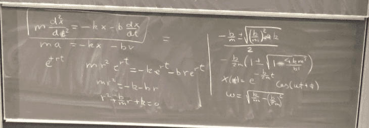

Can someone explain to me what my professor did?

Two things I don't understand; how did he get that omega is sqrt(k/m-(b/2m)^2)
And second; why is it that x(t) = e^(-bt/2m)* cos (omega*t+phi)
shouldnt it rather be; x(t) = c1*cos(ωt) + c2*sin(ωt)
I figured out why omega is what it is, but still don't understand how he got the equation for x(t)
I think he's assuming that the system is underdamped, so will be a damped sinusoid. The general solution can be molded into that shape:
##x(t) = c_1 cos(ωt) + c_2 sin(ωt)##
##~~~= \sqrt{c_1^2 + c_2^2}\left( \frac{c_1}{\sqrt{c_1^2 + c_2^2}} cos(ωt) + \frac{c_2}{\sqrt{c_1^2 + c_2^2}} sin(ωt) \right) ##
##~~~= \sqrt{c_1^2 + c_2^2}\left(cos(\phi) cos(ωt) + sin(\phi) sin(ωt) \right) ##
##~~~= \sqrt{c_1^2 + c_2^2} cos(ωt - \phi)## where: ##~~~~\phi = tan^{-1}\left( \frac{c_2}{c_1} \right)##
You can fudge the sign of the angle ##\phi## by negating it and interpreting it appropriately.

Aren't c1 and c2 constants? If so, I see a sinusoid, not a damped sinusoid.

Ah, right. I left out the damping term in the general solution o:) So:
##x(t) = e^{-\alpha t}(c_1 cos(ωt) + c_2 sin(ωt))##
Go from there. The roots of the auxiliary equation will be complex conjugates of the form ##\alpha ± \omega##, where ##\omega## can be further broken down as ##\omega = \sqrt{\alpha^2 - \omega_o^2}##

This is exactly the point where I don't know where to go from :P. Where does the c2sin(ωt) part go?

See post #3. The sin and cos terms can be amalgamated into a single cos (or sin) term with a constant phase shift.

Look at the undamped case:
##x(t)=c_1 \cos (\omega t)+c_2 \sin (\omega t)##
and
##x(t)=A \cos (\omega t+ \phi)##
are equivalent. Note that each contains two constants of integration.
