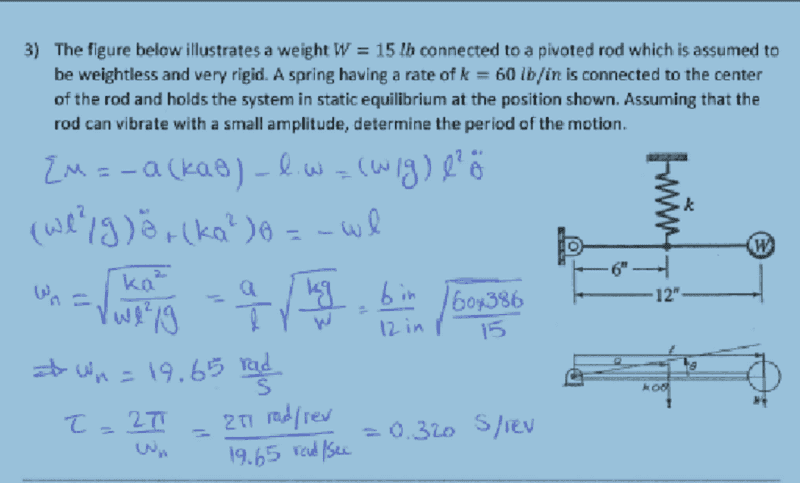

This isn't really a homework question... it's solved, but I'm having a hard time following it. I don't understand where the first term:
-a(kaθ)
comes from. I can see it's the moment relation between the hinge and the spring but why is the a term squared?
Value 'a' is used to relate the force generated by the spring to the angle θ and as the lever arm length for the moment about the pivot generated by the spring force .
Nidum said:
View attachment 197634Value 'a' is used to relate the force generated by the spring to the angle θ and as the lever arm length for the moment about the pivot generated by the spring force .
Looking at it again. I'm sorry. I think my problem was just misreading the answer.
Value a just the value used to reference the length? (6in)
This would make:
F spring = xk
x = aθ
Thus a(kaΘ) = M
And it's negative because the fbd assumes the weight is tending CW while the weight and the spring force tend CCW?
