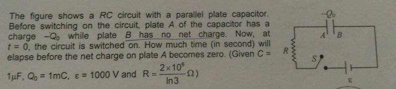

Hello everyone , this question has been troubling me for weeks,so if anyone could please help me out.i have attached the pic of the question.The answer given is 2 seconds but i am getting a different answer.

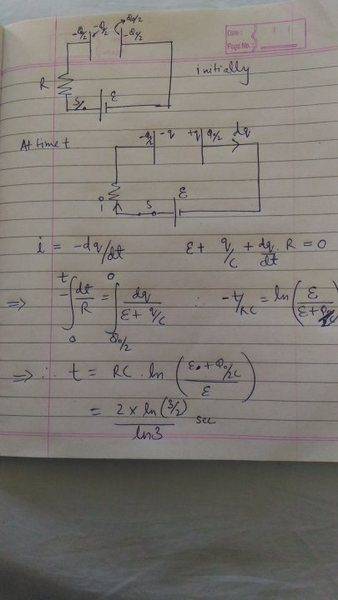

first of all i distributed the charge on the two plates so that there exist no electric field in the conductor.then i calculated the time taken to discharge the charge presant on inside half of the plates But the main thing that's troubling me is how to deal with the charge present on outside of the plate.
i have also attached my solution to the question.
That's not what the problem statement says. There is a net charge ##-Q_0## on plate A. Closing the switch will increase it to C/V as a function of time. Try to find that function and determine when it crosses 0 Volt.

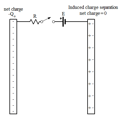

A schematic doesn't represent the true geometry of a circuit, it only depicts topology. Why not concoct a plausible "real" setup where you can justify charge locations physically? Maybe something like:
Assume that the dimensions of the resistor, switch, and voltage source are tiny compared to the plate size. Assume that their capacitance is much less than that of the plates. I don't show details of how the net negative charge on the left hand side will be distributed, it will depend on the plate thickness and proximity of the plates. Remember that a charged object will be attracted to a neutrally charged body if charge separation takes place.

I didn't have enough paper to draw it to scale :smile: Consider the plate length (and depth into the page) to be as long as you like to meet the negligible edge effect conditions.
As for your solution, I don't believe that you are permitted to distribute the initial charge on the left plate to the right plate. There is no path for this to occur before the switch is closed.

why? i have not distributed it from right plate to left, its the induced charge .and i have used basic rules
1)electric field inside conductor is 0 in electrostatic condition
2)conservation of charge

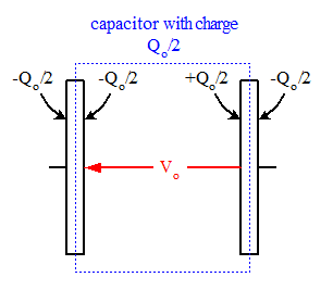

@Mausam , Looking again at your first post and the charge distribution on the plate surfaces it occurs to me that there may be a less confusing approach than what I've presented above. There I started without the induced charge separation and had it happen as part of the solution process using current flow. That's probably unrealistic and an overly complicated way to account for it.
This time, starting with the charge distribution that you found (which is correct), there is effectively a capacitor already charged to -Qo/2 (the two facing plate surfaces) holding a potential difference of ##V_o = (Q_o/2)/C## :
Note that the static charge Qo/2 has already been distributed via the induced charge separation so it exists on the outer surfaces of both plates already, thus it's not necessary to take it into account as a separate current flow as I was doing previously.
Now we can draw an equivalent circuit where the charged capacitor is modeled as an uncharged capacitor in series with a voltage source equal to ##V_o##:
You should be able to write an equation for the current with respect to time for this circuit and determine the time it takes for a charge Qo to flow.

@Mausam had the initial electrostatic charge distribution correct. There's potential energy stored in the circuit thanks to the charge separation that occurs on plate B and this manifests as a pre-existing (before the switch is closed) potential difference between the two plates: ##V_o = (Q_o/2)/C##. In this case since Qo is 1 mC and C = 1 μF, that makes ##V_o = 500~V##. The equal charges on the outside surfaces of the plates don't contribute to that potential difference.
If you wish you can think of the circuit as being comprised of a capacitor with an initial voltage of -500 V that will be heading towards +1000 V thanks to the external voltage source. So a ΔV of 1500 V, or a ΔQ of 1500~V / C = 3Qo/2 going from -Qo/2 to +Qo.
