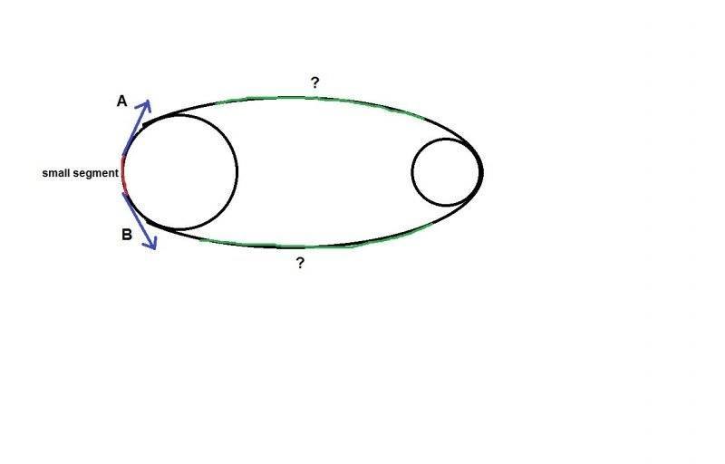

Thanks again. I have tried to think hard about this and have drawn a diagram (attached to this thread).
What has friction got to do with the tension not being enough when the belt slips? My thinking - when the belt is pulled tight around the pulley, the pulley pushes on the belt (normal force) which causes friction. The friction produced is proportional to the normal force. The normal force is therefore proportional to the tension. So if the tension is not strong enough the belt will not grip the pulley and they will move relative to each other. I just don't see how you can argue this case in terms of circular motion and centripetal force? Does the circular motion only apply to the belt when it is wrapped around the pulley? So the bits I have marked in green do not have (or need) any centripetal force?

The centripetal force, which keeps the belt pressed against the drum, is supplied by tension. The belt is not massless. So the faster it moves the more centripetal force is required to keep it moving in a circular path. So what happens as the drum spins faster and faster and the belt moves faster and faster? What happens to the normal force?

No, the normal force is the reaction of the drum pushing back against the belt. The belt pushes on the drum thanks to the tension being "resolved" into an inward force.
So if the tension of the belt cannot cope with the speed of the drum it will slip and as its does so will move relative to the drum and the normal force will become zero during the slipping? Is that correct?
Maybe not zero, it just has to drop below the threshold where static friction fails to hold the belt from slipping.

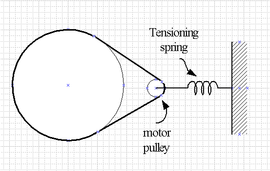

The tension is provided by the pulley. Usually the pulley is spring-loaded to supply the tension. The tension results in a centripetal force around the drum. The centripetal force that exceeds that required for circular motion of the belt pushes the belt against the drum. The drum then provides the normal force that leads to friction between the belt and drum.

The tension in a rope is due to some external forces acting on different parts of the rope. Such as two people pulling on each end, or two weights hanging from the ends while the rope passes over a pulley.
If the rope is a continuous loop (or a belt) it can also be imparted by pulling apart two pulleys that the rope passes around. For the pulley and drum setup of a clothes dryer there's usually a tensioning spring pulling the belt tight, sometimes pulling the motor pulley, sometimes as a separate pulley.

Thank you for the picture, that makes sense now. Are those points I made in my previous thread correct (as I edited them just a second ago).
