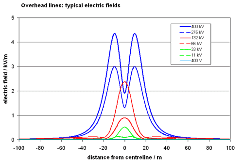

Here is a website dedicated to just the kind of info you're asking about.
http://www.emfs.info/sources/overhead/
Here is one of the graphics from that site.
Thanks a lot for the help. I did see that website, but it did not seem to specify whether the E-fields were radial (-∇V) or axial (##-\frac{1}{c}\frac{dA}{dt}##) or how they were calculated. I will definitely read up on it more.
