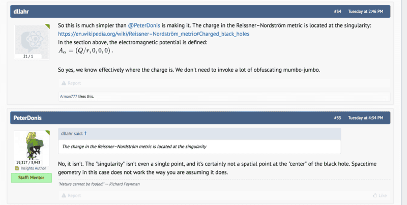

Where do the static electric field lines appear to originate from a charged black hole, non rotating, Reissner–Nordström metric?
I've had a number of qualified physicists say they appear to come from the center of the black hole, but people on these forums have said that doesn't make sense. They've also gone so far as to claim the singularity is not at the center of the black hole ... ?

There are two things going on here.
First, you can indeed find qualified physicists who will say that the charge lines "appear to come from the center of the black hole". That's a simplified picture appropriate for laypeople who won't be helped by a digression into why the phrase "center of the black hole" doesn't mean what it sounds like; and there's nothing wrong with it as long as you understand the limitations of that explanation and don't read too much into it. However, in an I-level thread we expect the discussion to go beyond that level.
Second, "appear to come from the center of the black hole" and "the charge...is located at the singularity" are not equivalent statements. The first is a statement about what the charge lines look like outside the black hole, whereas the second is a statement about the location of the charge (and a bogus one at that, because nothing can be "located" at the center).
There are actually several points involved here:
In Schwarzschild spacetime, the locus ##r = 0## is a spacelike line, not a timelike line, so it isn't a "location" at all--it's a moment in time, not a place in space.
In Reissner-Nordstrom spacetime, the locus ##r = 0## is timelike, but it is two timelike lines, not one, and they're inside the inner horizon, so they are not spacelike separated from any event outside the horizon. So describing this locus as "a place at the center of the hole" doesn't seem correct. (And for good measure, it's actually an infinite number of pairs of timelike lines, if you look at the maximal extension of R-N spacetime.)
Finally, R-N spacetime is an electrovacuum solution, which means there is zero charge density everywhere, so asking "where" the charge is located is meaningless, since there isn't any.
Center of the black hole is a pretty obvious concept, I'm not sure why you're trying to obfuscate it. Regardless of the level of the discussion, it serves as a good starting point. I'm not sure exactly what l-level means; I'd be happy to move the discussion elsewhere if that's going to be a big hang up.
Again, this is unnecessarily complicated, and misses the point entirely. From outside the outer event horizon, and a reasonable distance, we don't need to worry about if "the locus r = 0 is spacelike or timelike". It's ridiculous to say there isn't any charge - the black hole is charged. There are static electric field lines emanating from the black hole. According to the Reissner-Nordstrum metric you would measure static electric field lines, and it would appear as if they are originating from the center of the black hole. Good old vector calculus - Gauss's Law - comes in handy here.
No, it isn't. That's why we're going to the trouble to correct you when you use it according to your "obvious" intuition, since that intuition is wrong when applied to a black hole.
Then please show me where, in the Reissner-Nordstrom metric, there is nonzero charge density. If you can do so, it will be quite a trick, since the R-N metric is, as I said, an electrovacuum solution, meaning that there is zero stress-energy (except for the EM field) and zero charge density everywhere.
Outside the horizon, yes, this is a reasonable view. However, inside the horizon, the spacetime is no longer static, and the concept of "static field lines" no longer makes sense.
Nope, sorry, here you are applying intuitions where they are not valid.
