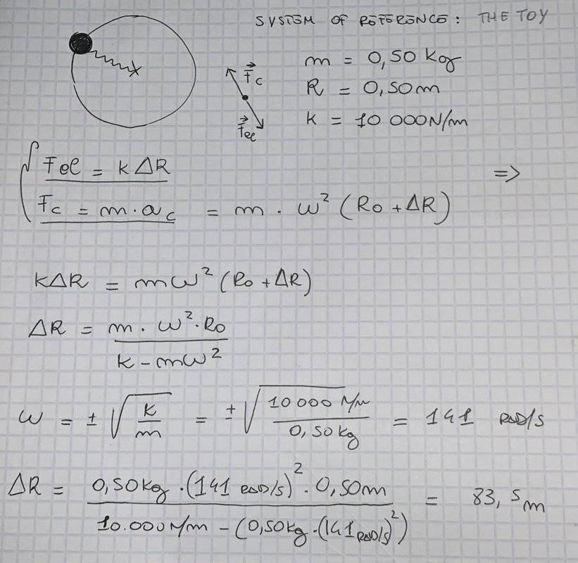

A child is playing with a spring (k=100000 N/m, Li = 0.5 m). One of his toys (m=0.5 kg) is attached to the further extremity. The child is rotating the spring above his head on a horizontal plane, with a uniform circular motion.
What is the elongation of the spring?
I’m not sure what is the right approach to this problem. I tried drawing a scheme of the forces as shown in the picture attached but I still have several doubts.
I thought the elastic force of the spring (Fel) that draws the mass towards the center, should be equal to the Centrifugal force (Fc) acting on the opposite direction and keeping the string in tension.
Hence I solved the problem equalizing them, as shown attached. I end up with a quite unlikely result (83.5m).
I don’t know if the initial condition is appropriate or if there are any other/different forces acting on the mass.
in the attached photo
Looks like some info is missing from the problem statement. How fast is the toy being rotated?
Once you have all the data, you'll want to draw a free body diagram for the toy. (Two forces act on it.)
Likes Ariano AnnaG

Your attempt includes a calculation of the SHM frequency for oscillations of the spring, but the question statement implies the spring extension is constant, so this is irrelevant.
As @Doc Al says, there is missing info... could be e.g. the angle the spring makes to the horizontal.
Likes Ariano AnnaG

the diagram of the forces acting on the toy is in the photo attached, it's quite small, between the datas and the drawing of the system.
I tought it could have been solved using angular speed ( radq(k/m) )
In the problem there isn't any other data
Yes, I saw that diagram but do not understand it. What two forces act on the toy? Those are the only forces that should appear in a free body diagram.

Here's the diagram of the forces
Again, I saw your diagram, but I don't understand/agree with it. Draw a new diagram in a vertical plane. What two forces act on the toy?

Ariano AnnaG said:
However, given the angular speed, would the equation I used be correct?
No. You assumed that the centripetal force was equal to the spring force. Note: Is the spring horizontal?

Yes, the spring is horizontal.
For the elongation of the spring to be constant, shouldn't the sum of the forces at the level of the mass be 0?
Otherwise shouldn't the spring describe also an oscillation of harmonic motion while rotating?
That is the reasoning I made to equalise centrifugal force and spring force.
No. The toy moves in a horizontal plane, but the spring is not horizontal. This is why I keep asking you to draw a new free body diagram!
No. The mass is accelerating, thus there must be a net force on it in the direction of the acceleration. (Note: "centripetal force" is not a kind of force, it's just a description of the net force needed to create a centripetal acceleration.)
I made a lot of mistakes and the problem is phrased in an ambiguous way and with missing data (angular velocity ω). However now I think I figured it out a bit better. Probably what created most of my confusion is the fact that the children is rotating the object above his head. However, I think I could consider the system just like the spring was fixed to a horizontal plane without drag. Given this, the mistake in my free body diagram is drawing 2 forces when there’s only one acting on the mass in a relevant way for the problem: the centripetal force given by the elastic force exerted by the spring.Thus given that mω2r = -kΔl I can find the elongation expressing the radius as a function of ΔlDo you think this resolution may be correct?Thank you so much for your replies, and I beg you pardon again for my confusion.
It is unlikely the problem is intended that way, and it does not help in resolving the missing information.
Just solve the problem in a general way: relate spring constant k, relaxed length Li, angular velocity ω to radius of rotation, angle θ of spring to horizontal and spring extension.
