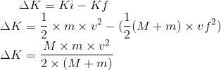

3)

3) View attachment 237159

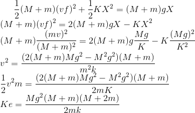

I got to this point, it looks like the alternatives but its still not there.
That's not quite right.
Total energy at (immediately after) the collision:
Kinetic: You should know this. General form is (½)(mass) (velocity)2 .
Potential Energy (two contributions: One of them could be zero.)
PE for the stretched spring. (Don't forget the factor of ½ .)
PE as gravitational PE.​
Total energy at the highest point. (Position at which spring is neither stretched nor compressed):
Potential Energy (two contributions: One of them is zero)
PE for the spring.
Equate these.
You seem to be able to substitute for ##X## just fine. For the square of ##v_f\,,\, ## use the square of your answer to question 2 exactly as it is given there.
How can I find the velocity at the highest point? From the theory of the SHM it would be the maximum velocity since X=0, but how can I find it?
Immediately after the collision the velocity would be vf, PE for the streched spring would be (KX^2)/2, and the gravitational PE could be zero if the reference would be the object, at the highest point I can't seem to find the velocity, the PE for the spring is 0 since X=0 and the gravitational PE would be (M+m)gx.
The velocity at the highest point is simply zero, that's why it is the highest point, it can't go higher cause the velocity is zero there and then the velocity starts increasing with the mass going downwards.
Likes SammyS

Leo Consoli said:
Then if my idea in the 11th comment is right the result after equating the mechanic energies would be:
Check your algebra.
(Answer to question re PE of spring follows.)
Leo Consoli said:
KX^2 times 1/2
Thanks, it was a typing mistake:
Very good.
Now substitute.
For ##v_f\,:##
For ##X\,:##
Simplify as well as solving for ##v##.

Thank you and everyone here for the patience, I was finally able to solve it, the answer was letter f, here it is, thank you again:
