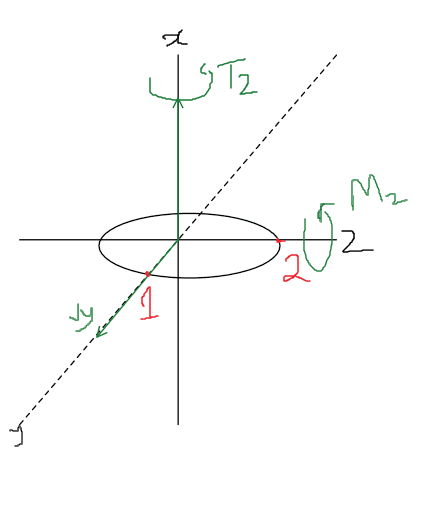

The problem asks to find out whether the rod yields at points in section A according to the tresca and von mises criteria
P is 120N
Shear stress= VQ/It
Stress= Mx/I
shear stress= Tp/J

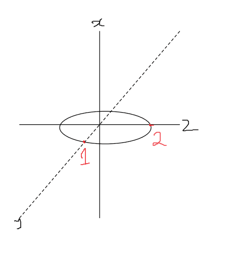

I picked 2 points at section A.
The first point is on the
I calculated that P will cause a shear stress Vy along the Y axis which is -120N
P will cause a bending moment Mz about the z axis 120N x 250mm
and P will cause a torque Tx about the x-axis 120N x 125mm
At point 1
Vy will not cause a shear stress because Q=0
Tx will cause a shear stress using Tp/J
and Mz will cause a compressive stress which will be at a maximum
Then i found the principal stresses using the mohr circle method
Then using the von mises and tresca criteria I compared the stresses to the yield stress of 200MN/mm to determine if the rod will yield.
At point 2
Vy will case a shear stress found by VQ/It
and Mz will not cause a normal stress because the distance from neutral axis for point 2 is 0 ?
This where I am stuck I am not sure point 2 only has shear stresses as I have calculated
and If i have picked enough points, as i imagine it will be the same values.

As I understand it, you've identified the reaction at A as the linear superposition of (1) A shear force in the y direction (2) a bending moment about the z axis and (3) a twisting moment about the x axis. The components of the stress tensor involved are xx, xy, and xz. What values to you get for these three stress tensor components at points 1 and 2, and how did you obtain them?
Looking at the base of the road, my 2 points are
so I got that..
Vy= -120N
Torque(Tx) = 120 x 0.125=15Nm(clockwise)
Bending moment (Mz)= 120 x 0.25= 30Nm
J = 2.03x10^-9
I =1.02x10^-9
Q=4.20x10^-7
At point 1, I think there will be no contribution from Vy to shear force acting on point 1
The torque will cause shear force which is found by (Tx * 0.006)/ J = 44.2 MPa (in the positive y direction)
The bending will cause a normal stress which is found by (Mz * 0.006)/I= 176.8MPa (in compression?)
The principal stresses I found using the
σ1=10.43
σ2=-187.23
For point B
I did the same thing basically but I found that there will be no contribution from Mz
This is because in the equation , Mx/I , x would be 0 because point 2 is on the neutral axis
so the contribution will be from Vy and Tz, which didn't make sense ..?

I confirm your reaction forces and torques, and your magnitudes of the shear and normal stresses.
Now, at point 1, I get the following state of stress:
$$\sigma_{xx}=-177.0\ MPa$$
$$\sigma_{xy}=-1.06\ MPa$$
$$\sigma_{xz}=44.25\ MPa$$
$$\sigma_{yy}=\sigma_{zz}=\sigma_{yz}=0$$
At point 2, I get the following state of stress:
$$\sigma_{xx}=0\ MPa$$
$$\sigma_{xy}=-1.06-44.25=-45.31\ MPa$$
$$\sigma_{xz}=0$$
I think our results are comparable, except for the xy shear stress at point 1 (which is not equal to zero). OK so far?
Thank you very much, this has really helped raise my confidence when approaching problems like this.
I had another go of it and I still don't understand the xy shear stress at point 1.
If it comes from the shear force Vy, wouldn't shear stress be 0 at point 1
The shear stress distribution is parabolic, so the maximum shear stress would be at the neutral axis and 0 at the ends where point 1 is, like in this image
there's something I am missing but I don't know what
Oh! It think you're right that in beam bending loading, the shear stress is distributed parabolically. Sorry. My mistake.
really?! I got something right
I think I messed up my calculation for Q though
Thank you very much for your help!
