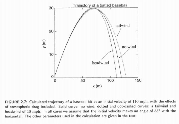

Recreate Figure 2.7 from Giordano's Computational Physics 2nd Edition

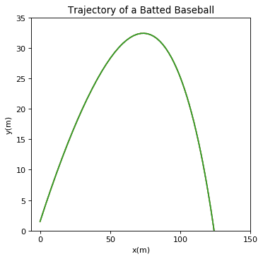

which pretty much yields the same plot with no wind.

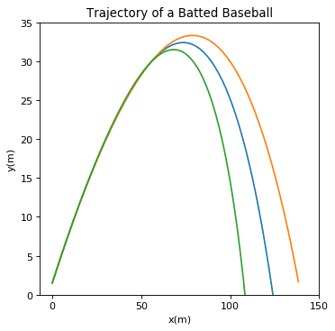

If I go ahead and uncomment the lines in the while loop. (line 54). The program breaks off into an infinite loop. I know because I outputted the y position of the no-wind and y is always hanging around the 28-31 range and never goes down (even after 1000 iteration). If I comment the lines again, the output is like 30-40 iterations and it's done.
If I change the wind speed of the original path, I can get the headwind and tailwind curves, so my physics is correct, but my programming seems to be at fault here. (So I apologize if this isn't a question for this specific forum) Does anyone have any insight why it infinite loops if I have 3 calculations in the loop but doesn't if it's one? Thank you!

Damn, that was the problem! I went ahead and each 6 arrays and added their 0th component by hand, and now the plot is display (roughly) what I need! Just need to clean it up a bit.
Good.
Interesting how the tail wind increases the max height. Logical, but not immediately obvious.
