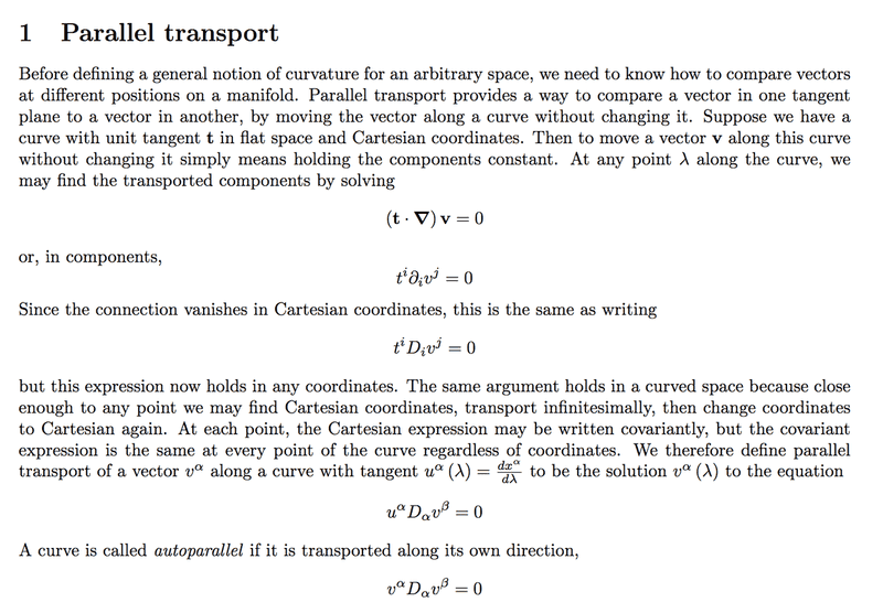

2*) From the following link http://www.physics.usu.edu/Wheeler/GenRel2013/Notes/Geodesics.pdf and more especially the following extract ;
I don't understand the first relation, i.e : $$(\mathbf{t} \cdot \mathbf{\nabla})\,\mathbf{v}=0\quad\quad(1)$$
which actually is equal to : $$t^{i}\partial_{i}v^{j}=0\quad\quad(2)$$
How can we demonstrate the equation (1) above ?
Is there a link with my first question, i.e it relates to the conservation of dot product value between $$\mathbf{t}$$ tangent vector and $$\mathbf{v}$$ vector ?
That is part of the definition of parallel transport, so it doesn't need to be demonstrated. If it doesn't hold then the vector field ##\mathbf v## is not a parallel transport.
What does need to be demonstrated is that a consequence of that definition is that the values of the dot product between the tangent and the transported vector are the same at any two points along the curve - what you describe as 'conservation of the dot product'. Integration is required to demonstrate that.
ok, I have found why equation (1) has this expression. Taking ##\tau## an affine parameter, we can write
$$ t^{i}\partial_{i}v^{j} = \dfrac{\text{d}x^{i}}{\text{d}\tau}\,\dfrac{\partial v^{j}}{\partial x^{i}} = \dfrac{\text{d} v^{j}}{\text{d}\tau}\quad\quad (2) $$
So in flat space (i.e Euclidean), the straight line parameterized by ##\tau## and on which the vector ##\vec{v}=v^{i}\,\vec{e_{i}}## is transported, makes vanish the expression ##\dfrac{\text{d} v^{j}}{\text{d}\tau}## because the components doesn't vary during the transport.
Now, I have to generalize this Euclidean example to Curved space and undertsand in this case the using of Covariant Derivative which replaces the expression above ##(2)## with :
$$\dfrac{D\,v^{j}}{\text{d}\tau}=\dfrac{\text{d}x^{i}}{\text{d}\tau}\,\nabla_{i} v^{j}=t^{i} \,\nabla_{i} v^{j}=0$$ with ##t^{i}=\dfrac{\text{d}x^{i}}{\text{d}\tau}##
Thanks
