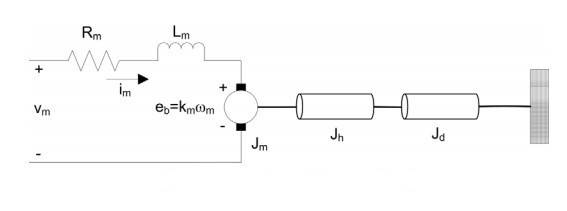

Hello,
I got the following diagram, shown below, and I have to derive its transfer function. I think I have a general misunderstanding about the transfer functions. What I think it is, is: output/input basically. As input is the whole block of things that affect the output.
This is the system that I have.
After doing some thinking how to start this I came out with the following:
[tex] v_m ( t ) - R_m i_m ( t ) - L_m { \frac {\ di_m (t) } { dt}} -k_m ω _m ( t ) = 0 [/tex]
It was said that we could ignore the inductance as the motor resistance is much bigger so I came up with as solving for im(t)
[tex] i_m (t) = {\frac {v_m (t) - k_m ω_m (t) }{R_m}} [/tex]
I am given also a expression of the motor shaft equation:
[tex] J_{eq} ω_m (t) = τ_m (t) [/tex] , given that the Jeq is the total moment inertia acting on the motor. Also the torque is given by [tex]τ_m = k_m i_m (t) [/tex]
I also know that the Jeq = Jm + Jh + Jd
With Jm and Jh given in a separate table.
I've found Jd to be [tex] J_d = {\frac {1}{2}} m r^2 [/tex]
So far I've only seen transfer function of an electrical circuit like RC and RL circuits. As I am studying electrical engineering I am kind of confused how I am supposed to derive the transfer function with all this torque and angular velocity. I am asked to derive the transfer function of input voltage and the angular velocity.
I can see that I can substitute what I've found for im into the torque equation, but don't know how then I can turn that into the (s) domain.
Any guidance is much appreciated !
Thanks
gl0ck said:
I can see that I can substitute what I've found for I am into the torque equation, but don't know how then I can turn that into the (s) domain.
How do you go from the time domain to the s domain in a purely electrical problem??
also I might be wrong but it looks like there is an error with the equation you were given
wm is angular velocity.
Jeqωm(t)=τm(t) should be Jeqωm'(t)=τm(t) given that friction is 0.
also here is a handy guide that derives motor speed / armature voltage.
http://ctms.engin.umich.edu/CTMS/index.php?example=MotorSpeed&section=SystemModelingnote: you may be thinking of transfer functions in an odd way. Below is something to maybe help you understand?

I don't know if you are familiar with Laplace?
You start from the left with:
1) Summation block: +Vm, -eb, output = Verr.
2) Find Im, multiplying Verr with 1/(Rm + sLm), output = Im
3) Find motor torque from Im
4) Find dω/dt from torque, inertia
5) Find ω by integration
6) Find eb and feed back to summation block 1)
Now use Mason's rule to calculate the transfer function of the system.
Thank you both for the answers. donpacino, I looked at the link it helped find the transfer function in my case. What I found more helpful actually was the comment below. I also found the book Modern Control Systems quite helpful understanding some basics.

gl0ck said:
Hello,
Jeqωm(t)=τm(t) , given that the Jeq is the total moment inertia acting on the motor.
Whoever gave you that equation owes you an apology. It's dimensionally incorrect. Otherwise I think your approach is good.
First, you have two k_m, they are not at all the same constant, so come up with a new one relating current to torque, say k_t so that torque = k_t times current..
OK, it's been years since I worked on this forum and my Latex is rusty so let me give you some verbal leads:
1. Change that equation to torque = J dw/dt where w is your lower-case omega.
2. Use your other two equations relating motor current to torque and dw/dt. Laplace-transform all three equations, then you have
W(s) = F(s)V(s),
W - transformed w
V = t ransformed v_m
F will contain K_m, k_t, R_m, J_equiv, R_m and of course s.
You could also find the transfer function relating dw/dt to v_m if you wish. That would relate applied input voltage to acceleration instead of velocity.
If you have a finite load, the torque-current equation must be modified. If the load toque is constant or linear in one or more derivatives of your dependent variable then you just solve that modified ODE. Otherwise you are stuck with a non-linear system. Cf. hint of post 6.
