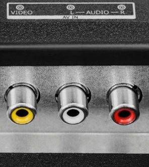

It's been more than ten years since I bought my LCD HDTV, so I have no experience with current TVs. I went to the Best Buy website and picked a TV more or less at random: a Sharp LC-40LB601U, a 40"-class LED 1080p smart TV. The pictures show the following inputs on the back for old analog devices:
Yellow is composite analog video. White and red are left- and right-channel stereo analog audio. I suspect most all TVs sold in the US still have these inputs in addition to the antenna input and the HDMI inputs for other digital devices. Does your TV have them, too?
My old VCR has matching yellow/white/red outputs. Does yours?
If the answer to both questions is "yes", then get a set of three RCA-type cables to connect the matching jacks, and set your TV to the corresponding input.
Likes Buzz Bloom
Hi jt:
YES! I actually have three old VCRs, and two of then have three outputs similar to your picture. One has them has the yellow/white/red colors you mention, and the other has orange/white/red, but their labels are as you describe. So I thank you very much. I have not hooked any of them up yet because I do not currently have the corresponding wires. I will either get some or improvise.
