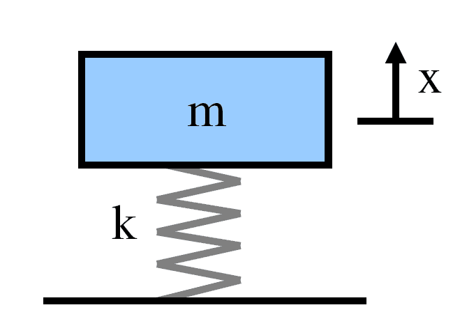

Professor gave this very simple homework where I need to convert the system below to a state-space model.
The system itself is represented by the equation
Code:
m*x" + k*x = f(t)
Where m = 5 and k = 1. Note that, " (doublequote) is a second-order derivative.
Unfortunately I don't have the background to solve it because I slacked too much :redface:
State-space model that we use is below:
Any help&explanation would be appreciated, thank you.
EDIT: Ok, I've just read the rules and apparently I'm not allowed to as for solutions without an attempt to solve it. Since I can't even attempt, may I ask a good place/source to start?
attempt:
Code:
5y" + 0y' + y = u
since my diff. eq. is second order, I should have 2 state variables:
Code:
x1 = y
x2 = y'
so the state space model's matrixes become
Code:
A = [ 0 1 ]   B = [ 0 ]
    [ 1 0 ]       [ 1 ]
C = [ 1 0 ]   D = [ 0 ]
does it look ok?
Dude,
A = [0 1]
[(-k/m 0]
-k/m = -1/5 lol!
