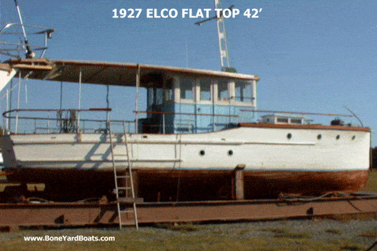

60hp is a big motor to me. What kind of boat are you building?Elco and Grebe yachts from 1920's used what they called "Canoe" hulls to achieve best speed with the modest powerplants available then.
http://www.boneyardboats.com/Archives/0030_Winter_2006/

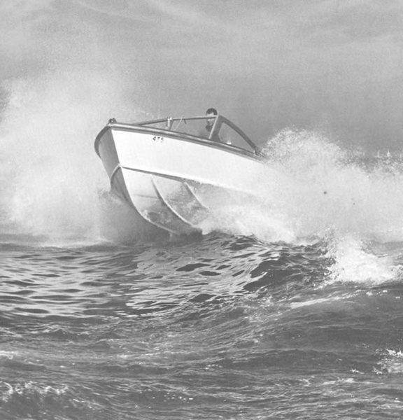

Planing hulls are a lot different from displacement. Once it climbs up over its bow wave and rides on only the aft quarter of the hull , ordinary viscous drag is significant ... so you want to make lift to reduce wetted area by tricks like trapping air under the hull (as in hydroplanes) and deflecting downward the water that's moving sideways out from under the hull . Turned down chines and lifting strakes as on Richard Bertram's famous "Moppie" hulls are examples of the latter.
http://www.powerandmotoryacht.com/design/understanding-hull-design
http://www.navaldesign.co.za/articles/Planing Hulls 07 Oct 2006.pdfVery old "Rudder" magazines might interest you, as will Ralph Munro's "Commodore's Story" which popularized his "Sharpie" hull.
Interesting project.
http://www.huntdesigns.com/deepv-questions-answers.htm
see the lifting strakes ?
[URL=http://s232.photobucket.com/user/oldjimh/media/bravemoppie-lg_zps030b57a5.jpg.html][PLAIN]http://i232.photobucket.com/albums/ee289/oldjimh/bravemoppie-lg_zps030b57a5.jpg[/URL][/PLAIN]
bigger photo here:
http://forum.woodenboat.com/showthread.php?94771-Do-Wood-Cigarettes-Exist
