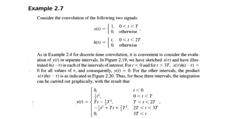

Hi all, I hope you all can help me
so I'm studying for my signals course and I encounter this example in the book, and the answer is there but the solution isn't... The convolution integral exists for 3 intervals and I could evaluate the first two just fine... however I can't find the limits of integration of the third.
The third one corresponds to the fourth in the picture which is 2T < t < 3T
The question and answer is shown in the picture attached
Thank you!
No relevant equations
I believe that the lower limit should be -2T + t, and the upper limit should be to T.
Limit for what ? This will become clear when you post your relevant equation: the definition of a convolution. Per that definition, the integration limits for ##\tau## are ##-\infty## and ##+\infty##. Of course for most ##\tau## the contribution is zero. Except for ##\tau\in [0,T]##
Yes actually the relevant equation would be
x(t) * h(t) = (from -∞ to +∞) ∫x(k)h(t - k)dk where K was used in this case instead of tau to avoid confusion...
However as shown in the file attached there is more than one interval of integration...
I need the limits of the fourth one where 2T < t < 3T
You mean: 2T < t - k < 3T
Remember: k is your integration variable, NOT t ! And its limits are ##-\infty## and ##+\infty## .
true, it's limits are from -∞ to ∞
however, what is the range on which evaluated integral is nonzero... when 2T < t (is constant) < 3T
if you check the picture I attached there are many intervals on which the integral is evaluated
on the fourth interval 2T < t < 3T, when is the range on which the integral is nonzero?
The point is that k is the integration variable and t - k is the argument of the function h(). You want to intgrate the section where the argument is in ##[2T, 3T]##
