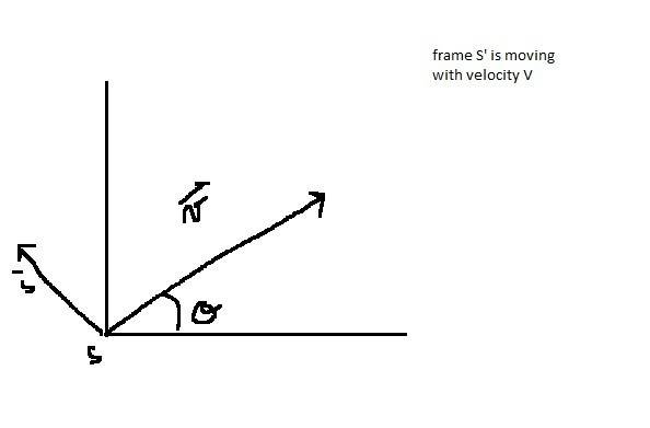

In the figure, let S be an inertial frame and let S'
be another frame that is
boosted with speed v along its x'-axis w.r.t. S, as shown. The frames are pictured
at time t = t0 = 0:
A) Find the Non-relativistic transformation (Galilean Transformation) between the two frames

The basic idea is correct, but it seems there is some confusion of velocity and position in the solution. I suggest that you introduce frame S'', which is rotated with regard to S but is stationary. Then find transformations between S and S'' and S' and S'', and combine them.

There are two kinds of rotation: rotation of an object in a fixed frame, and rotation of the frame with a fixed object. They have similar rotation matrices; in fact, one is the inverse of the other. Your matrix is that of object rotation, while you need one for frame rotation.
Here is how you can deduce the correct matrix easily: let's say the object is at (X, Y). X = R cos α, Y = R sin α, where R is the distance to the object and α is its polar angle. In a frame rotated by angle θ with respect to xy, the distance to the object does not change, but the polar angle is (α - θ), so X' = R cos (α - θ), Y' = R sin (α - θ). Using trigonometric identities, you should get X' = X cos θ + Y sin θ, Y' = X sin θ - Y cos θ.
I am not sure why you are considering rotation with fixed translation, it does not really help you here.
Transformation to a rotated frame moving with constant velocity v along its X' axis is best done by considering the stationary frame S'', whose origin O' = O, and which is rotated by the same angle. Then (X'', Y'') = rot(X, Y), where rot is the matrix discussed above. (X', Y', T') = (LorentzX(X'', t, v), Y'', LorentzT(X'', t, v)).

You have two transformations, which look correct. But you have only two frames denoted in your solution. You can't have two transformations between two frames, it does not make sense. This is why you are confused. You are almost there, but you need to label all the THREE involved frames and the corresponding quantities correctly.
orrite, i will try again with S being our normal rf and S' the fixed rotated and S'' the moving rotated
