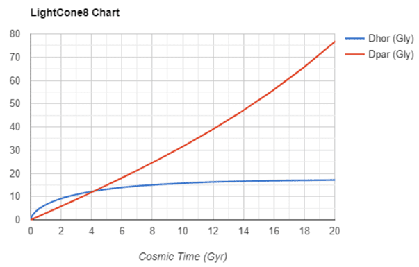

Using LightCone8 Cosmological Calculator and PLANCK(2018+BAO) data as input, we can get the following result:
In the figure, Dhor is the event horizon and Dpar is the radius of the observable universe. Currently (t = 13.79 Gyr) Dhor has a value of 16.58 Gly. Does the event horizon have any real effects? How should we view the following writings:

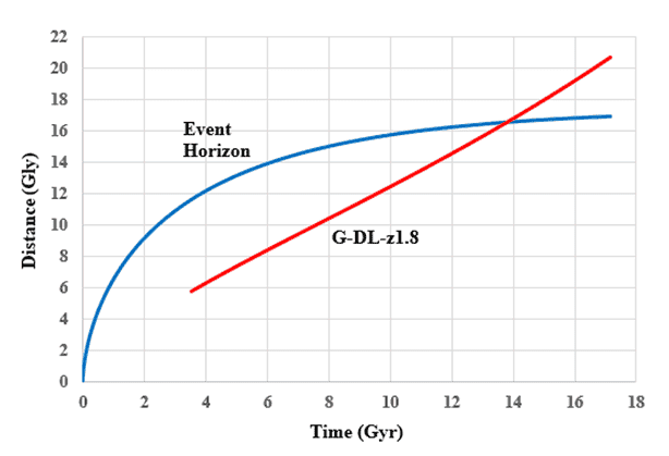

Let’s label the galaxies in question as G-DL-z1.8 and illustrate the above writing with a diagram. LightCone8 and PLANCK(2018+BAO) data gives the following result:
In the figure, the distances to the event horizon and to the G-DL-z1.8 galaxies are plotted as functions of cosmic time. The results are summarized below:
  1. Photons received now from a G-DL-z1.8 galaxy were emitted at t = 3.527 Gyr (z = 1.852). At that time, the galaxy was located at a proper distance of 5.813 Gly from our location.
  2. Now (t = 13.79 Gyr), due to space expansion, the G-DL-z1.8 galaxy catches up with the event horizon at a proper distance of 16.58 Gly from our location and at a recession speed of 1.146c.
  3. From now on, no photons emitted by G-DL-z1.8 will ever reach our location (i.e., its new images will not be observable).
  4. An observer at our location, however, will continue to see the old image of G-DL-z1.8 for a long, long time because the emitted photons when the galaxy was close to, but inside of, the event horizon will have prolonged journeys to reach our location. This is because the recession speeds at those locations are of the order of c. It will be interesting to demonstrate this with calculations using LightCone8.

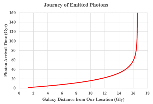

Let’s use Gnedin’s calculator to do the demonstration. If we aim a telescope to a direction in space, we receive photons from galaxies at various distances. Let’s assume that each of these galaxies emits a pulse of photons now at the same time. We want to know when these photon pulses will reach our location, i.e., to get a relation between the distance at emission and the photon arrival time at our location. The result is shown below:
Photons emitted by galaxies close to, but inside of, the current event horizon (16.58 Gly) will have prolonged journeys. For example, while it will take photons emitted now from a distance of 1.479 Gly 1.556 Gyr to reach our location, it will take a photon emitted at 16.52 Gly 99.79 Gyr. Note that this result is consistent with the statement that photons emitted now outside the current event horizon will never reach our location.

Corresponding result obtained with LightCone8:
