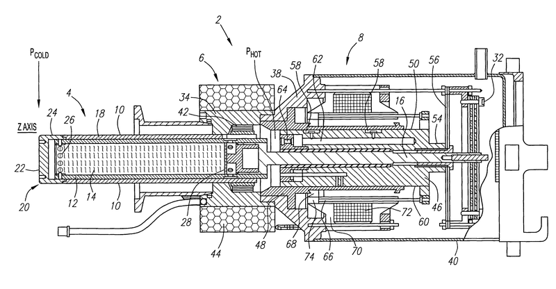

I have a design in my head how I like it to be in the end and that is pretty much the same principal and build of a typical cryocooler design like the beta design in this patent. I thought that it would will be better to use a detailed picture then to write pretty much the same my self:
If I would have write up any basic design it would look quite similar to the one above, I have however thoughts on using magnets instead of the springs just to see how that would be but I will se how I do with that since I have not got to that test phase yet.
Gasbearings do I see as must for this design as to instead use any Teflon, graphite or similar would not hold in the length and thus planned to use stainless. That would however not be allowed to hit the walls due to wear that could prevent function and thus gasbearings.

You may have considerable difficulties in converting that patent drawing into a practical design .
Personally I would go for something based on the simple and elegant Phillips - Stirling concept with mechanical drive .
We can discuss any proposed design a bit more though if you want to .

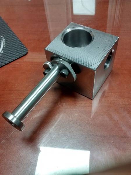

This thread came at a convenient time! I was in the same boat as you, I was interested in making liquid air for a while and tinkered with JT throttles a little bit. I finally decided I was going to pick a design and try and recreate it! I chose this after a bit of research:
A simplified version mind you, If this thing runs for more than 6-10 hours in its life I will be surprised. Weight was no problem (it's not going to space). Ease of machining was key. I'm going to externally drive it. I will be using lead shot in my regenerator. I will initially test run pressurized with air. Then hopefully if it works switch and try helium. It's not finished yet, I have been puttering away at this in my spare time.
For scale, The regenerator is 5.1875" overall length.

(c) Yea that what I thought about in the above patent drawing that there is equal 300PSI pressure on both sides on the piston and thus it only need to create a pressure of 150 PSI and also easier if only a small distance. But I am quite sure there are other reasons for the piston/cylinder size apart from this thing. But ok then I know the basic reason for that.Im not going to rip the measurement straight of it or so but the principle only because this type have fast cooling and is small. But yes I have had the Phillips - Stirling variant in my head as well. There is this video on youtube, (doesn´t work to post youtube links?) just search for Stirling Cycle Part 2 (Stirling Cryogenics) there, where they use one of these types and they wnt down to temp really quick and created liquid air quite fast and a lot of it as well and that was a classic Philip - Stirling.
Have not found the patent on that exact variant though which bugger me, but that would be alternative two to make if I will not have time to build something like the one in the patent or any other problems arise. Some of the reasons I would like to build the one in the patent is because they have a very long life since there are pretty much no friction between the piston, regenerator and the cylinder wall due to the gas bearings but also since it could be made very compact.
If it takes to long to make this I would probably go over to the mechanical Philip - Stirling concept and just have the other one done the day it will be done. But even that one require some advanced math which I don't like to deal with.

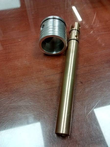

Just an update then, I got it together enough to try. I was unsuccessful. The temperature differential I achieved was a measly 10 C. I tried charge pressures ranging from 0-200psi. And rotation speeds from 1-2000rpm. Everything was sealed up nicely, If I left my charge valve open I could see a pressure spike while rotating.
If I reversed rotation I got a higher temperature on the cold head.
I'm not sure what to try next... I think perhaps I have too much parasitic loss. Maybe the wall thicknesses on the regenerator and the cold head leg were too thick and are conducting too much heat to the cold head.
I tried lead shot and screens in the regenerator.
*just a note on the orings, I figured they would be fine to seal, at least temporary for proof of concept, especially since they are on the "hot side" of everything.
To get my sizes I printed the image out and scaled everything off of that. I have cad data that I have sketched out. It, isn't neat or tidy though! Just a quick sketch!
Any Ideas?
Ben
Just a little more info, The piston diameter is 1.200" regenerator is .500" OD And the stroke is .35"
Im not an expert in this by far but as far as I have understood it all so to get down to low temperatures you among many other things need to cool the compressed hot gas (air in your test?) as much as possible and also prevent any losses as far as possible. If you want to get down to cryo temperatures then it is an absolute must.
Don't know if this next thing makes much difference in your design but to fully utilize the regenerator the material you use need to be the one that was planned to be used and thus not fex the material of a thick walled tube which draw out the heat from the generator material and will not release it back as fast or at all as the regenerator material was design to do.
The use of o-rings, I don't know if this might make a huge difference in your case but this could perhaps be one of the reasons since these make a lot of friction and thus heat. I would personally instead have tested to make anything that move with fex graphite mixed epoxy instead with closely made clearance to the cylinder. But the cylinder then need to be very smooth like the inside of a glasstube or the piston clearance would very fast be bigger and quickly loose its sealing ability.
Btw, where have you got the calculations from to make the sizes of the regenerator and piston?
