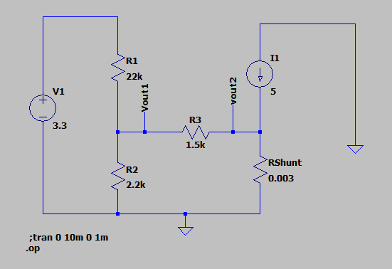

I have taken portions of a schematic for amplifying the current I1, this I1 current is the phase current from one of the legs of the inverter. The output vout1 is the amplified voltage, again given to a micro which has internal opamp. Is my circuit understanding correct?
When I give I1 = 10 Amp
Vout1 = 0.1457
Vout2 = 0.03
Amplification factor = 0.145/0.03 = 4.833

when I1 = 20 Amp
Vout1 = 0.162857
Vout2 = 0.0600002
Amplification factor = 0.162857/0.0600002= 2.7

The amplification factor is not constant, as expected it to be constant. Please advise.

That is not an amplifier.
That is an attenuator, with a DC offset.
d·Vout1 < d·Vout2
Likes DaveE
I am sorry for naming convention the input side is vout2 and the output is vout1 which is greater than vout2. Vout1 is given to micro input.
I get that. But Vout1 is an attenuated version of Vout2.
Look at a voltage step on d·Vout2 and you will see the d·Vout1 step has less amplitude.
Vout1 has a small DC offset added. That does not constitute gain.

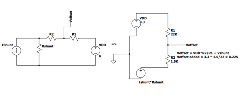

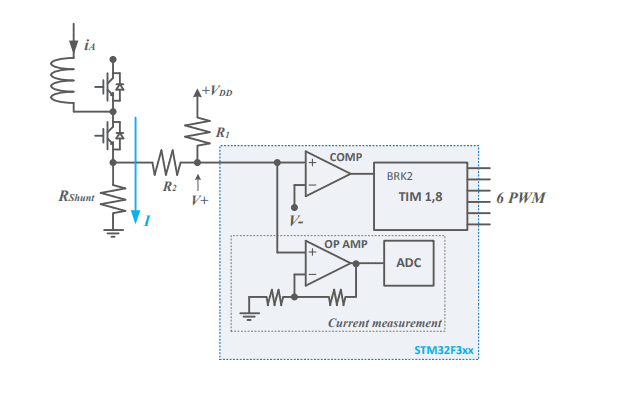

Yes now i understand it is not amplification circuit, when i was going through the documentation
Userguide on page 29, fig29. I was trying to calculate the offset as mentioned by the document
"The voltage drop on the shunt resistor, due to the motor phase current, can be either positive or negative, an offset is set by R1 and R2"
Is the offset calculation of 0.225V is correct? i simplified the circuit by removing the opamp as no current is flowing into it.

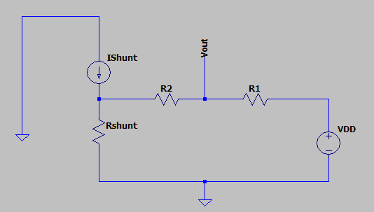

No.
1) When you replace the current source with a voltage source equivalent, you can't remove the resistor ##R_{shunt}##, it should be relocated in series with ##R_2##. This is the Thevenin/Norton source transformation, an extremely powerful and simple tool in circuit analysis.
2) However if ##R_{shunt} \ll R_2##, then ##R_{shunt} + R_2 \approx R_2##. Then you would get your equivalent circuit as an approximation.
3) Your offset calculation shouldn't be a simple ratio of resistance, it's a voltage divider.
Try again
Ok i try again
This is the original circuit for the comp. I modify this circuit as
Ckt1
The voltage drop of Ishunt across Rshunt is V = Ishunt * Rshunt, hence i replace the current source with the voltage source, the modified circuit will be
Ckt2
Applying the Kirchoffs laws
$$I = \frac {(VDD - V_{Shunt})} {R_1+R_2} $$ ->eq1
$$V_{out} = V_{shunt} + IR_2 $$ ->eq2
simplifying the equation is
$$V_{out} = \frac{(VDDR_2+V_{shunt}R1)} {R_1+R_2} $$ -> eq3
Please correct if i am wrong i will apply Norton theorem.
One doubt i am getting now is can i consider Vshunt as voltage source?
That is what it is, a differential voltage source.
Why do you think that might not be the case?
Nope, that is what Thevenin's theorem is all about. You can't make a resistor just disappear in the circuit transformations. What you can do is convert parallel branches with just a current source and just an impedance into a branch with a voltage source in series with an impedance, they will have different values according to the transformation rules. This isn't difficult to learn, prove, or remember, IMO. Read the link I posted earlier. This is absolutely worth learning ASAP, it will be incredibly useful for you.
However, your answer is the correct approximation when ##R_{shunt} \ll R2## as I stated before. This is almost always a useful simplification for current sensing circuits.
The exact solution is
$$ V_{out} = I_sR_{shunt} \frac{R1}{R1+R_{shunt}+R2} + V_{dd} \frac{R2+R_{shunt}}{R1+R_{shunt}+R2} $$
