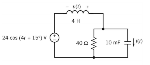

I am given the following circuit:
and asked to solve for v(t) and i(t)
If this is right, I don't know where to go from here.
Check the signs in your R||C calculation.
One place you can go from there is to find the current from the source, hence the current through the inductor. You could then determine the voltage across the inductor due to that current. Then you're on your own to use that knowledge to proceed further.
