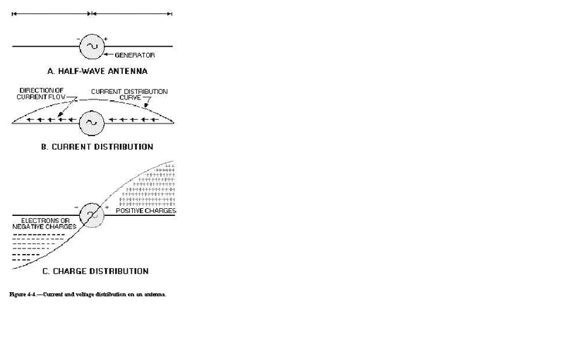

Current direction in dipole antenna
In summary: But according to the polarity shown , is the current flow direction correct ?In the next cycle , the polarity of the source will change and the direction changes as well.

Is the current direction shown correct ?

i am just concerned with the direction. I think current flows outwards from the positive terminal of the source. But in the figure it is opposite.
could be talking about electron flow rather than conventional current...
The antenna is being fed by AC so why are you concerned with direction? Think of it as electrons bunching up on one end and then running back to the opposite end over and over. I would say the diagram is correct. It is a snapshot in time though, not a steady state representation.

Yes the current flows out of the +ve side which in your case is the +ve voltage direction so I am is +ve.

I think the direction shown is wrong. If you replaced the antenna with a capacitor (appropriate for a short antenna) then the current would be flowing INTO the Capacitor from the positive terminal. and Back Out into the negative terminal.
But you need to remember that the two are out of phase (quadrature), in any case, so the direction thing is not meaningful as one 'changes direction' whilst the other is going through its [edit: max or min] value. Basically, don't worry. Once you get as far as the SUMS, it will sort itself out.

The diagram is correct. If the antenna is actually radiating, the current has to flow the same direction on BOTH sides of the feed line. Could the antenna be fed if the current was flowing in opposite directions? Think about the current in the feedline. You are correct in saying that in the next cycle everything changes around.
As I stated in a previous post, and yes I'm sure sophie is cussing me at this moment for bringing those little devils into this, think of it as electrons bunching up on one end and then running back to the opposite end over and over.

Of cause the direction keep changing. But you can just set it with a reference direction like op defined +ve at one direction. That's how books doing it too.

I got it...thank you all.
One more question
I read this somewhere for current and voltage distribution that voltage will be minimum at center where current is maximum. How can it be possible for the voltage to be minimum at center? May be i read wrong

It is correct that the current is max at the center and voltage is at minimum. You read correct.
That's right. If you take the two halves of a dipole and bend them so they are parallel, you will have a quarter wave transmission line. This line will have an open circuit at its end, with a current minimum and a voltage maximum. It is terminated with an open circuit (high impedance) and the quarter wave line transforms it to a low impedance at the feed point. As you spread the wires apart, the same thing applies but the impedance of the line is different.

It is not true, it all depend on the length of the dipole as shown in my equations. Books claimed it is too difficult to get the exact expression of the current, so they approximate using phasors with open termination at the end as show in my first post. The equation specified for the length h compare to quarter wave that if h> quarter wave, the max is somewhere in the line, not at the end due to sum of the forward and reverse voltage phasor.

But it's true for up to and a bit beyond a half wavelength dipole and particularly for the dipole shown in the original diagram. Yes, you can arrange for a high drive-point impedance if you make the dipole still longer or if you drive it at a point not at its middle. That just adds complication I think. The exact current distribution is very difficult and the 'end effect' is also there to upset the voltage distribution. I'll bet all that wasn't included in your first introduction to antenna theory! :wink:
