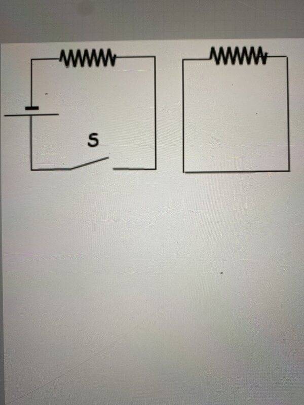

Hello! I have a question regarding an induction exercise. It says “The current induced on the right side circuit by the left circuit after closing the interruptor is.....”
a. clockwise
b. counterclockwise
c. other
I would appreciate any help. There is no additional data given.

Is there a specific way the current flows? I know the current on the left side is moving counterclockwise causing an “outwards” magnetic field. So does the second circuit establish a current in that same direction, or in the opposite direction? My profesor never explained this topic but says an exercise related to this will appear in the test.
That magnetic field will "link" with the right side circuit. In which direction?

That’s what confuses me. Do I take Lentz law into consideration? If I do then the current on the right side circuit will love clockwise. If Lentz Law does not apply then the current would be the same as the inducing current.
Magnetic field due to a current carrying conductor "encircles" the conductor.
So, when the switch is closed in the left circuit, which way will the magnetic field be in the right side circuit?

clockwise?
sciencec said:
clockwise
I asked magnetic field direction, not the current direction.
Can you draw the magnetic field lines formed by the current in the left side circuit?
Hints: 1) Magnetic field will be perpendicular to the plane of the screen.
2)Magnetic field due to a current carrying conductor "encircles" the conductor.

Oh right sorry English isn’t my first language.

As far as geometry is concerned, you have correctly drawn the magnetic field.
You also correctly said the field is "outward" in the left loop. So the field "linking" with the right side is in which direction?

inwards.

Yes.
So the right loop saw a sudden "increase" in the magnetic field "inwards" (into the plane of the screen). How will the right loop react to this change?

It will react to the increase in inwards magnetic field by “creating” (don’t know what word to use) an outwards field to counteract, meaning the current will be counterclockwise.

Yes.
But I beileve this problem is poorly framed.
1) The two circuits are drawn with lumped circuit abstraction, which means there should be no fields and the geometry of the two circuits won't matter.
2) If the problem-setter wanted to demonstrate Lenz law through this example, it would be better to use coils instead of resistor loops IMO. Then it will no longer be lumped element abstraction and you can analyse it using fields. (If the lumped element abstraction is considered in this circuit, there is no magnetic coupling between the two coils. So, no induced emf and induced current.)
Maybe I'm being pedantic here, but if I were to set this problem, I would use coils instead of lumped resistor loops.

I agree with that. I was also confused when i saw the problem initially because of the use of resistor loops instead of coils. Aside from that, thank you very much for taking your time and helping me i greatly appreciate it.
Likes cnh1995
LOL guys, are those two lumped elements in the pictures , representing a resistor or an inductor? I thought it was an inductor lol...
They look like resistors to me ;)
If they were inductors, their winding directions need to be given, as you said in #3.
Likes Delta2
I don't know where the zig zag lines are inductors, but perhaps they are somewhere?
I took them as resistors and the induction was due to the parallel wires.
If they are inductors, there ought to be some indication of the sense of the windings. Also there should be some indication of coupling. As someone mentioned, if they are purely schematic, so that you can't assume those two wires are parallel, then equally you shouldn't assume the coils are coupled.
Likes Delta2
My bad, I think @Delta2 's demon tricked my mind and made me see inductors there while they are resistors .o_O
Only if mutual inductance between the two "coils" is assumed.
If the mutual inductance is between the wires only, which is the case if they're resistors, then the direction of winding of the coils would be immaterial.
