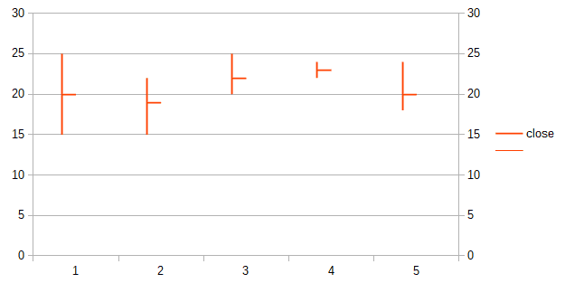

I just noticed that LibreOffice has a chart style for stock prices which includes the ability to display daily price ranges in a manner suitable for indicating uncertainties of data points.
This is the example of a LibreOffice stock style chart
The bottom of the vertical data symbol is the low price for the day, the upper limit is the high price and the horizontal line is the closing price so it is easy to configure them represent a mean and uncertainty

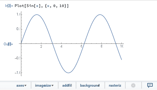

You can use https://www.wolframcloud.com. It is free as long as you don't run out the credits, and it supports the succinct wolfram language. In other words-- it is an online mathemtica.

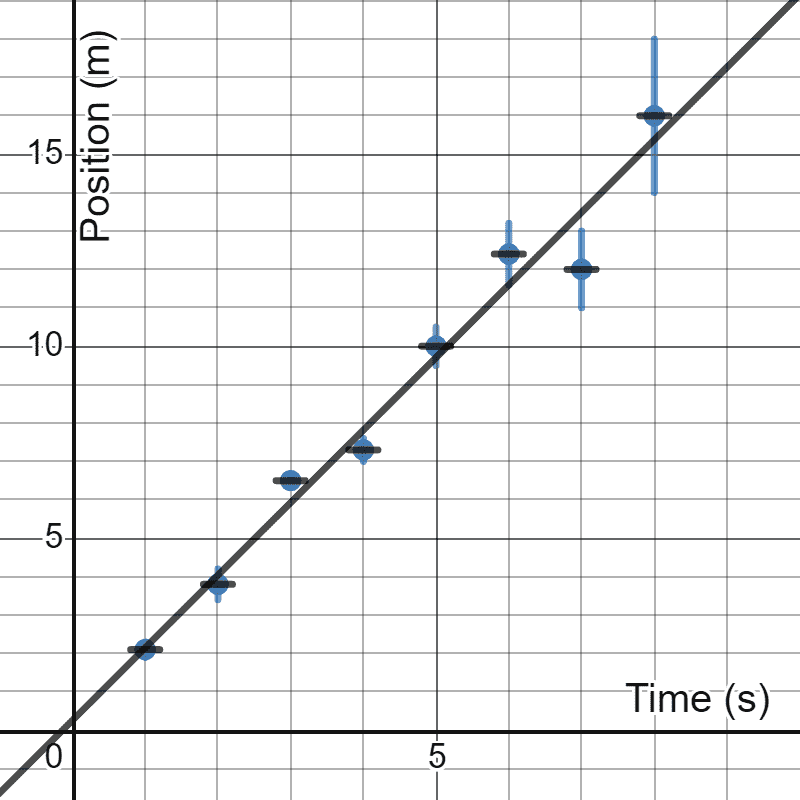

Here's a Desmos solution, if you're still looking. Your students might come in familiar with Desmos from math classes. For IB physics, students are supposed to play around with maximum and minimum slope lines to get uncertainties which is how I started playing with it. Here it is with those sliders.
