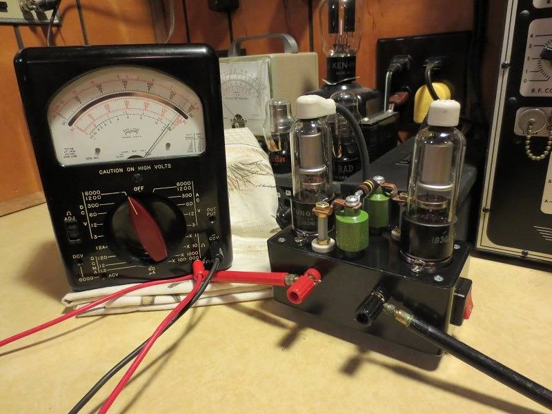

Have you ever considered tubes? :approve:
I apply ~4kV (full wave rectified) when playing with my vacuum deposition system.
