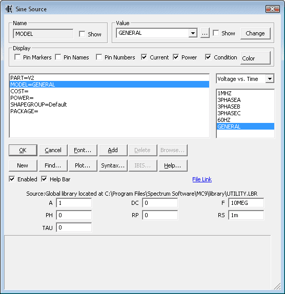

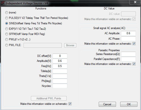

Please double-click on one of the voltage sources and show us the model. You may be able to answer your own question by just looking at the default model you are using... 😉

That's the whole voltage source model? What simulator software is that?
Let me check my MicroCAP SPICE package...
@berkeman
Its ltspice...This might help you!
Yes, that's better. So if you leave that "Series Resistance" box blank, what do you think it defaults to?
In MicroCAP-9 you can see what it defaults to...
Likes brainbaby
I think so it refers to the internal resistance of the voltage source.
Yes. Isn't that what you are trying to determine with your simulation? Or did I misread your original post?

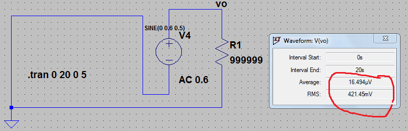

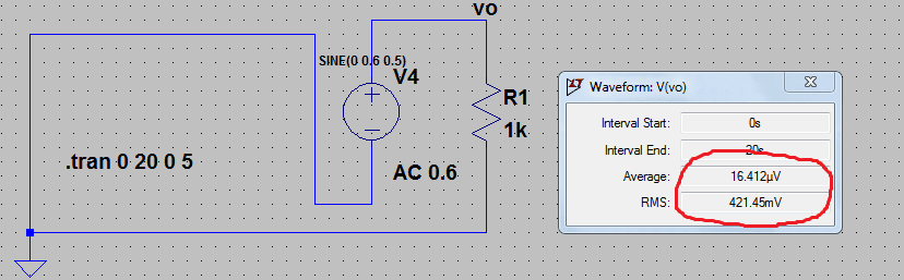

I will reiterate again..
My question is that I have taken two values of load resistance for this circuit ...
one is 1k ohms and other is 99999 ohms (open circuit voltage).
My aim is to find the output impedance...
The output impedance, is equal to the difference of the open circuit voltage and output voltage when load resistance is present(i.e 1k) over current flowing through 1k load resistance.
But after simulating I found that there is no significant change in the output voltage , in other words in this case the output voltage is independent of the load resistance value...which I don't think so is theoretically valid...
The thing about simulation tools is they are idealized environments. In the real world a voltage source with zero output impedance (ie the output voltage is independent of the load resistance) does not exist, you can have very low output impedances, but not zero.
However when simply solving equations, which is all the simulation tool is doing, you can most certainly set the source impedance to zero, just like you can set a load resistance to zero, which will then make the computer complain (or crash if it's poorly implemented code).

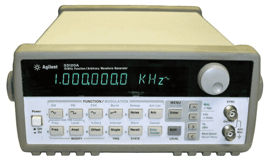

BTW, the output impedance of real signal generators (lab instruments like the HP 33120 Signal Generator / AFG) is generally 50 Ohms on purpose. That makes the interfacing with other 50 Ohm instruments more straightforward.
Quiz Question for the OP -- So if I monitor the output of the 33120 with my oscilloscope in the lab, and set my 33120 AC Voltage Output amplitude to 1Vpp, what voltage do I see when I use a high impedance 'scope probe to check that output voltage? What voltage do I measure on my 'scope when I use a direct coax to my 'scope when I set the input coupling to 50 Ohms versus DC 1MegOhm?

No. Instruments that have a 50 Ohm output impedance expect to drive a 50 Ohm load. So you get 1Vpp when you connect the signal generator to a 50 Ohm load.
If you drive the output into a high impedance, you see 2Vpp when the signal generator is set to 1Vpp. Can you say why that is? :smile:

Most likely because the output impedance of those default voltage sources in your simulator are close to mine, which is in the low miliOhm range. So essentially zero output impedance by default.
Instead, use a single voltage source in your simulation and set its output resistance to 50 Ohms. Then try a few load impedances to plot how the output voltage from the source to the load varies with load resistance. That should help you to understand what is going on. Have fun! :smile:

LTspice models voltage sources as having Rser = zero, unless you specify otherwise.
The source resistance of the three perfect voltage sources in series is zero.
